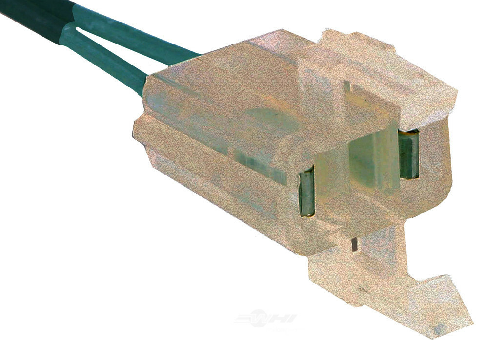

So I'm so close to having my k5 ready for the road but the only thing hold me up is I have zero brake lights. I have the switch but the plug in my harness seems to be mia... can anyone post a photo of what it should look like as I have no square buds around me? Truck is a 86 k5 with a 90 harness in it but I believe the plugs should be the same
Someone can correct me if I'm wrong, but I want to say this is the correct style, if the link works:
https://i.ebayimg.com/images/g/pEMAAOSwUM9cqEmf/s-l1600.jpg
If it is, that vendor is calling it a "PT142".
looks like it to me
same size terminals tho as reg flat spade . if your in a pinch and need it working 2 female spades that are insulated would work .
and should be orange and white wire pair . if i recall
