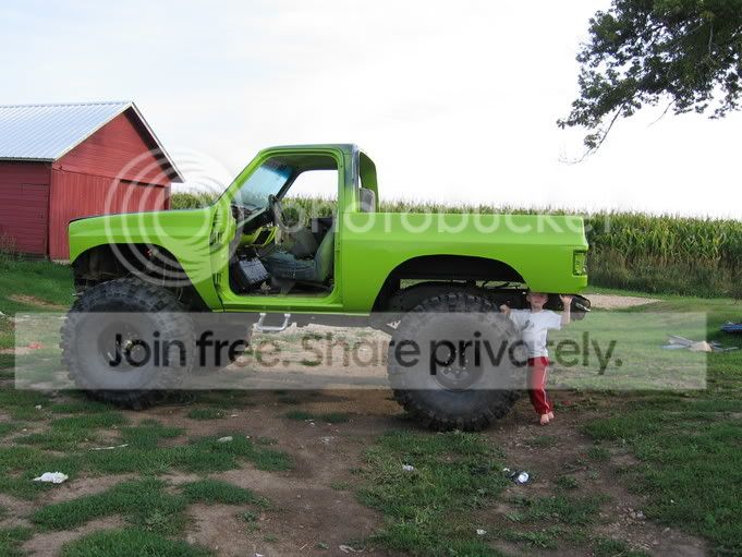

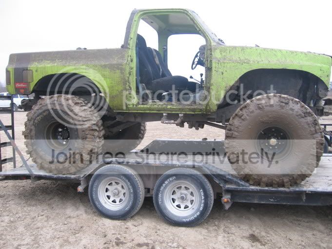

this is what my k5 looked like with 44's. it has 4"rc lift and a 3" bl, oh and a zero rate up front. it would rub a little at full lock when it was at full stuff. i was happy with it. just can't belive that i'm going from 44 boggers to 38 tsl's:doah: :doah: :doah: :doah:

always liked the way it looked. why to 38s???????????
i just re-did most of the drive train. i swapped to a th400 and 205.i also am putting a dana60 together with a spool and 5.13,yukon 4340 shafts, drive flanges and i'm going to full hydro.oh and i'm puting in ths s@w 10 point cage so i'm thinking that i'm going to take the body lift off and run the cage to the frame. when this is done than i will look in to making some drop hanger for the front and run 52's. not shure what i will end up doing but i will be getting some new meats, thinking about some fresh 44" boggers or maybe the 47" ltb's but they look a little skinny. you know how it is, you build it than rebuild it and then do it agin. some day maybe it will be done. than agin this was stock 3 years ago.
i needed the 38's to get into the Cliffs, i talked to someone out there and they said that they did not want anyone in the park with tires bigger than 40"s. i think that it is silly. it's not like i'm going in to run the easy trails on 44" boggers.
