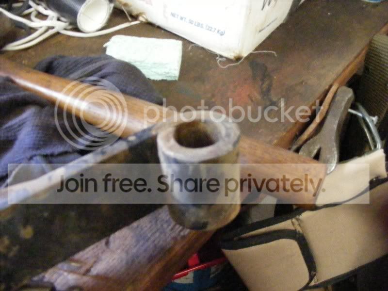

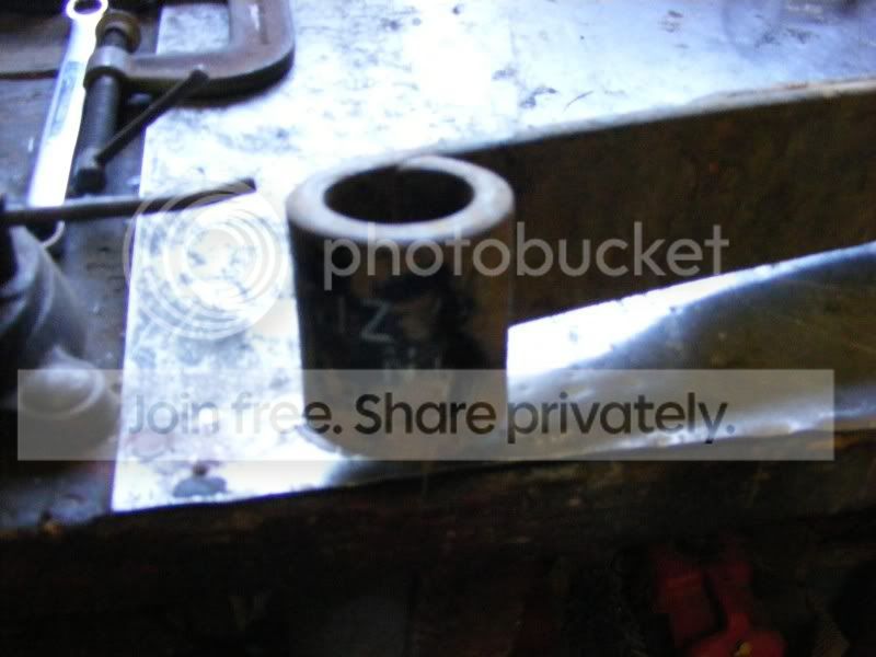

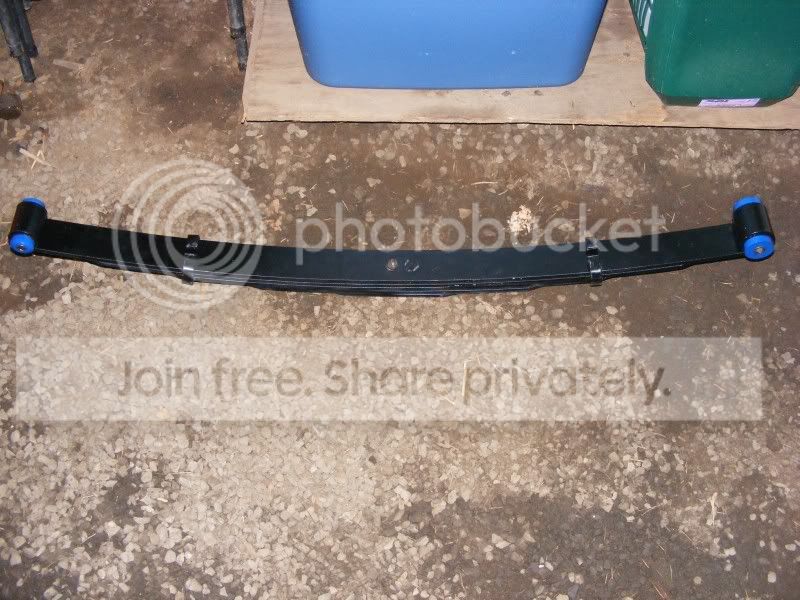

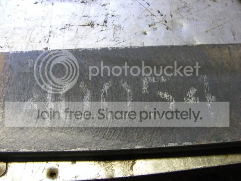

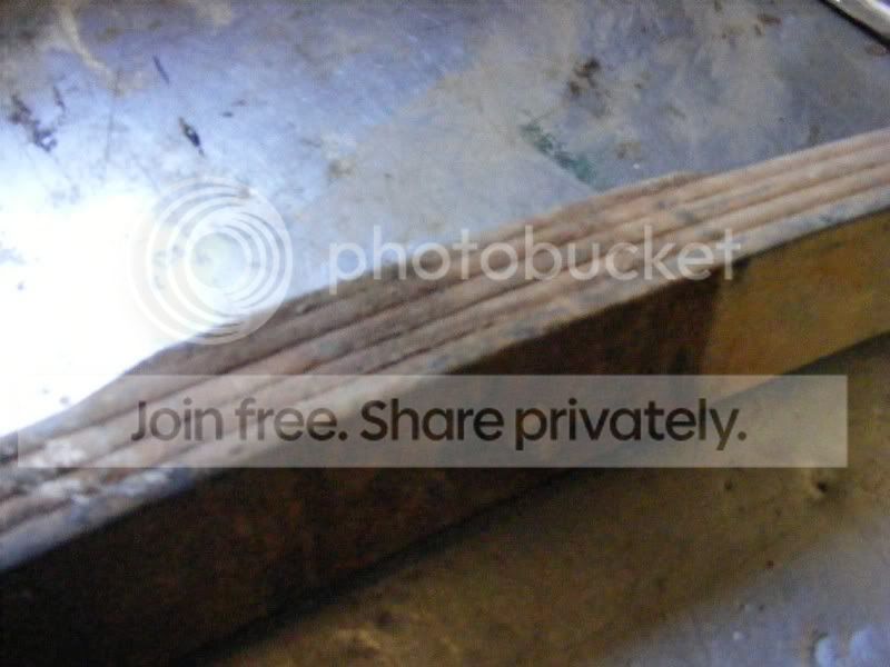

Got my front springs almost ready... I was told they were Rancho but I figure I'd ask and see what you guys thought.
The only markings I could find were "Made in Brazil" on the big spring eye and 40054 painted on the top of the main leaf. Here's some pics:
I'm fairly sure they are.. I got some Energy Suspension spring bushings from thatk30guy that were for any front lift spring except for Skyjacker or Superlift.. they fit snug as a glove in these.
Who makes blue urethane bushings? I went to energy suspensions site and they show only red and black.
Tarey
Energy Suspension is who made them.. no idea if they are a one off or anything like that, thatk30guy might know(bought them from him).
The blue is kinda cute, isn't it?:haha::haha::crazy:
