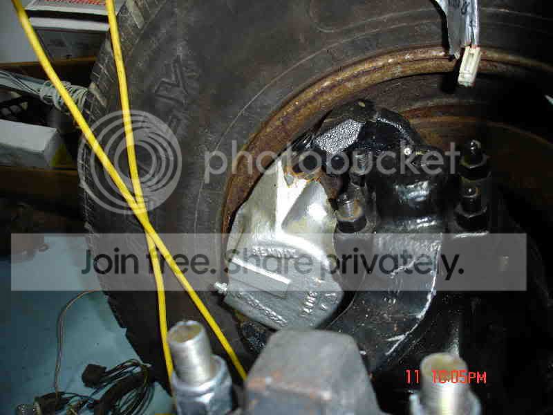

Is this driver side caliper on my dana 60 on the correct side? I'm about to start plumbing the brake system and the bleeder position had me curious. Is it possible to put these chevy calipers on the wrong side?
thats not right. bleeder should be up on top. me thinks you have calipers flip flopped
The Calipers should be marked "L" and "R" on the Bendix models. Check the part number. It should read: XXXXXXXX - "L" or "R". That will tell you if you have them right side or backwards. Can't make it out in the pic.
Manny
Yep , it's on the wrong side ,the bleeder needs to be on top or you will never get all the air out.
haha, yeah i thought they were wrong.. I musta had too many rum and cokes the day I put those on. While i've got the thread started, does anyone see anything wrong with this set-up..
