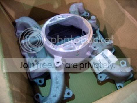

A friend of a friend recently won a government auction that contained a crate of misc. items, including around 30 (yes, thirty) brand new J-code single plenum truck version (not Hummer) intakes.
A buddy is picking one up for me this weekend. Let me know if anybody is interested and I will put you in touch with the guy. I believe he's asking $20 each.

I'm out of town this week on business and don't have the contact info with me. Friend at work was supposed to pick me one up this weekend, if so I will make sure it's the same as the picture and get the guy's info.
Got my intake...just like the pictures showed....brand new...mine was still in the original box that had never been opened.

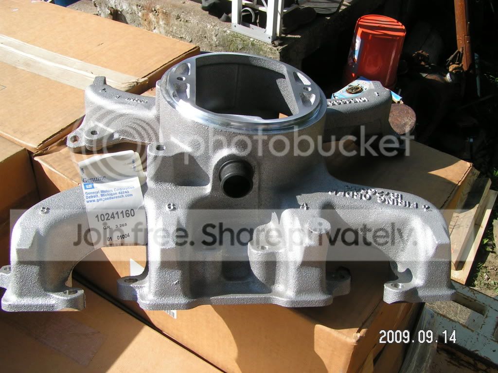

Finally got around to putting the new intake on last night and found it needs a few modifications to work.
There is an extra cast-in mounting tab with a drilled and tapped hole on both sides in the rear. In the first picture look on the driver's side rear runner, right above the GM parts tag. On the bottom picture look right below the parts tag on the passenger side and the corresponding tab on the drivers side.
You have to chop off the tab on the passenger side for sure as it hits the vacuum pump...you can't even get the manifold down against the engine. Not sure on the drivers side but I went ahead and chopped it off to.
Also, on the flanges around the bolt holes on the front and back I had to trim them up a little to fit. The back drivers side goes right up against the glow plug controller bracket and the fronts sit right against the thermostat housing pipes, again not letting the manifold sit flush.
It got late so I didn't try much, but appears I will also need to hog out the bolt holes like mentioned in the stickied manifold swap article. I could start the bolts on the passenger side but couldn't on the drivers side. Looking down into the holes they appear to be slighty off.
Not 100% sure what these are for as the 6.2 versions don't have this tabs. Thinking maybe the late model 6.5's with the engine cover????
