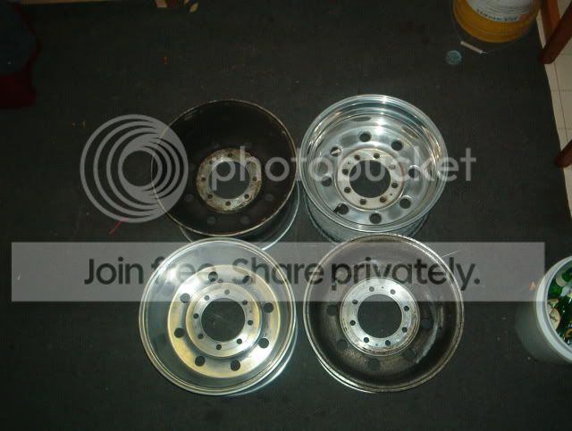

I paid a guy to do mine...he owns a small business and did them as a side job....once he found out they were forged he knew he was screwed...he had to buy a bunch of different grit wheels to sand the wheel to get it smooth, then he had to polish it....he had power buffers set up on a stand, and holding the wheel he would work the different bars of polish to achieve the resulting final finish. I actually helped him with the last wheel as I was tired of waiting on him to finish them (5 mo.) and we worked the last wheel through 3 compounds of rouge and took an easy couple hours to do that....in all I would say he had over 100 hours in refinishing the set....I felt bad that he worked so long and bought a bunch of different finishing bars and wheels I give him and extra $50 I think....it is a job that is time consuming and laborous. Your hands will probably ache afterwards too!
Forged wheels stripped chemically to clean them....
This after about $300 in labor and materials by the polisher for all 4....as it turned out he made about $1/hr on these. But he's got more materials in stock now!
