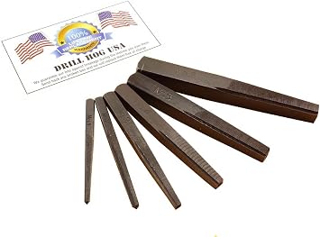

Just to add my 2 cents but these square style extractors work awesome for broken pipe fittings and such.
https://www.amazon.com/CTA-Tools-90...F8RW55K622R&psc=1&refRID=WDQGXSB90F8RW55K622R
