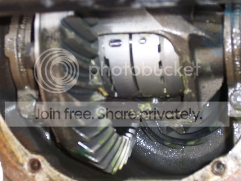

well this is what it looks like with the cover off
notice the teeth when i turn the tire
this is how i would think it would work since i'm supposed to be able to turn with this, but the first 2 times i went out wheeling with it, it caused my steering to feel different, like it would pull to one side or the other and never want to go straight, now it feels like it did before i locked it

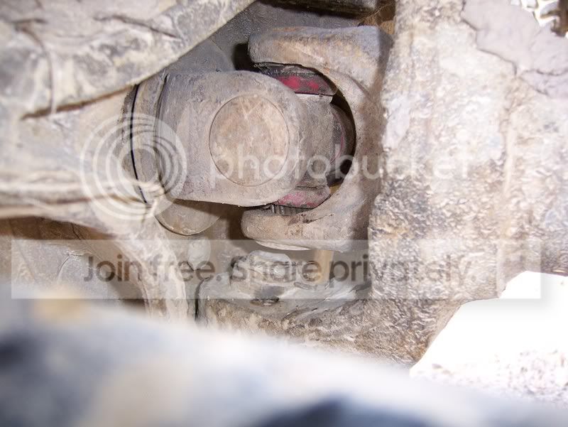

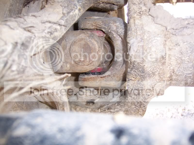

also found this wrong, but not the cause of the problem

is that how it's supposed to work? when i first put it in it was engaged all the time and you couldn't turn the wheel if the other was on the ground and both hubs locked
Hard to tell, at the end it looks like you are getting some clicking but no movement on the locker? You need to simulate the torque input from the driveshaft to have an accurate look at how everything spins. Mine does alot of the same, lots of clicking but both seem to still turn. Some have said they are designed to be that way, called a ratcheting locker. No one has confirmed wether it should click or not while driving straight.
