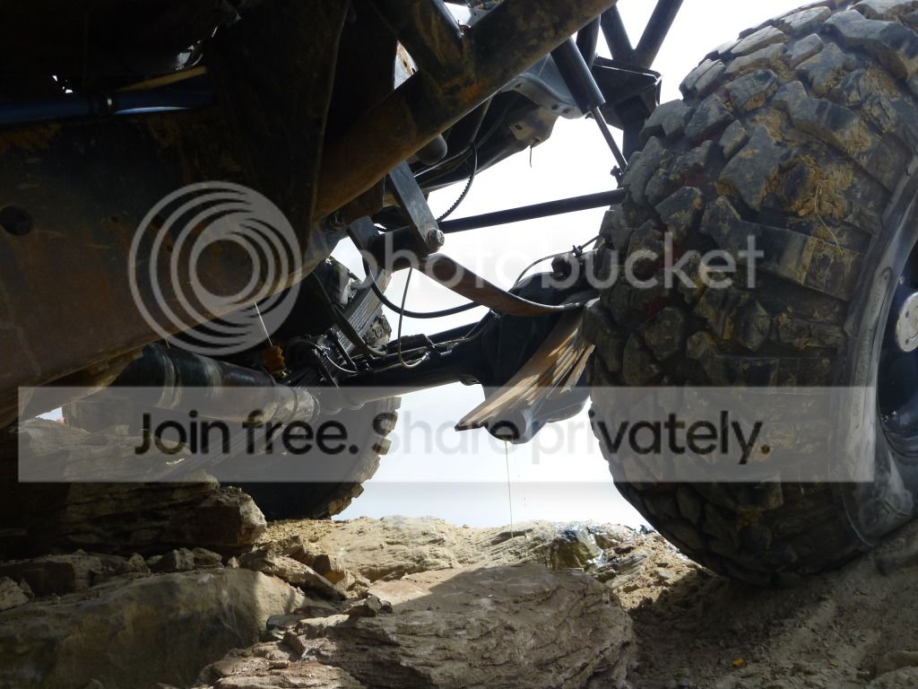

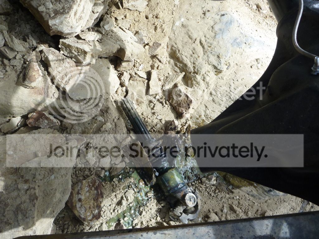

Worse thing about leaf springs in these type rigs is as the axle droops the pinion points down more then puts more angle on all the joints. Here is a friends with the same 1350 CV/1410 axle and dropped out getting hung up on a ledge and leaf springs allowed axle to walk and bound up at pinion and broke it off. He has also broke 2 of the CVs while in Moab with us because of same problem after he corrected pinion angle and added straps.
lack of straps and retainers. he fixed after that mishap.
After he fixed that and added shims to correct pinion at full droop it would still bind up the CV side and first time broke the centering pin and second time broke the flange yoke. Mostly the way the leaf springs dropped out and the angle of the springs wasn't the greatest geometry. On my Sonoma I shortened up my shackles and lowere the front down a few inches to make my leaf springs flat instead of at the big angle you see when people do 52s and longer shackles. By doing that I eliminated teh need for shims to correct pinion and the axle travelled more vertiaclly instead of swinging forward as bad. I also ran straps/bumps and limited my front to around 11" of travel. I figured I was better off lifting a tire every now and then than breaking a leaf springs or binding up a shaft.
