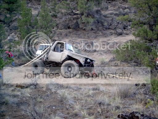

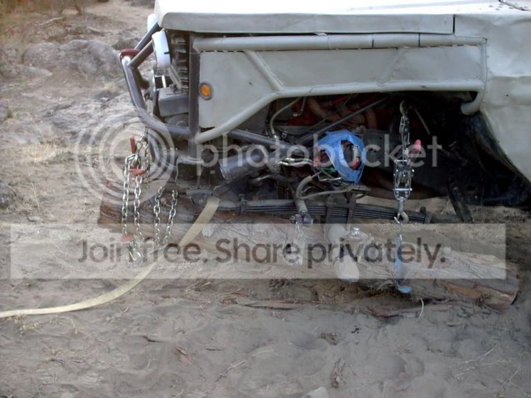

One of the guys I Wheel with has a winch mounted high on the back of him rig. Chain or tie that axle end up as high as you can get it. Use your winch to tie on to the back of another rig and drive slow, would be one way

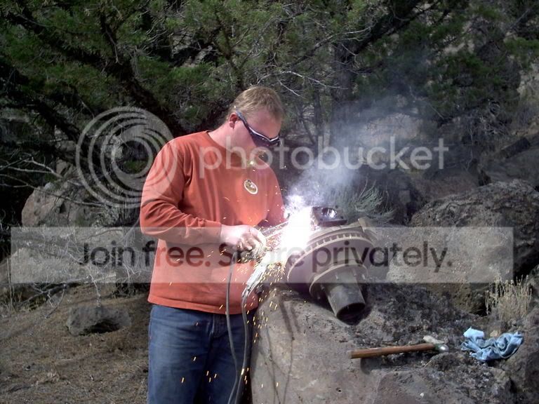

bad spot to be in for sure, it took me about 9 hrs to get mine on a trailor. went on a parts run to start with and couldn't find one. then a guy that was with us had an onboard welder and welded it up
that didn't work, it broke as soon as it had weight on it. i guess he had the wrong rod or something? i wanted to hook to another truck with the winch but my truck was way bigger than the others. buggies and sammies. so pretty much drug it the whole way. it sucked!! needed that heli.

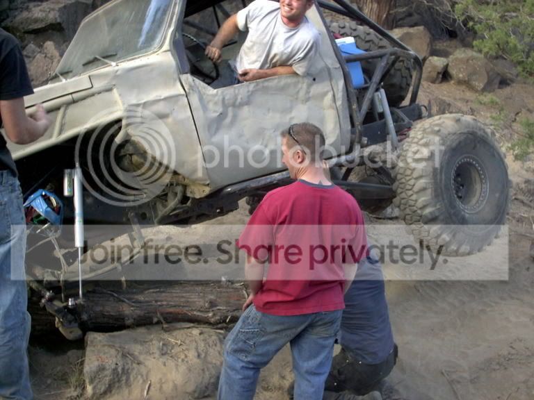

A guy in my club used to have a 4 runner that he had a big problem breaking steering knuckles on. I dont know exactly how they broke but I do know that several hundred zipties were used to get him off the trail on more than one occasion. Let me see if I can dig up a pic.
I was not present at the time, but 78Buford broke a knuckle on his Ford D60 last year. Fortunately it was still partially attached but kept folding under. I think basically they ratchet strapped it as much as possible and then just drug it off the trail. Unfortunately the fullsize truck was by far the biggest which didn't help, otherwise they could have just winched the bumper tight together and drug it out. From the part of the trail it was broke on is normally easy to drive out and takes maybe 15 minutes to the road, but it took several hours in this case.

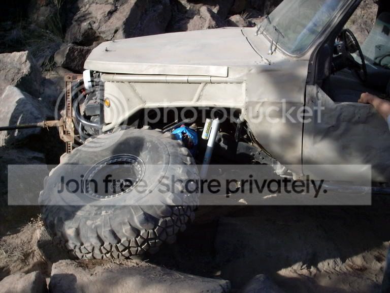

I had driven up a fairly nasty hill in August of 2005. The hill is nicknamed "Butttpucker." It was dry, and I made it without any real trouble. When I made it over the top, I was "wiggling around" to park out of the way for the next rig to attempt the hill. The steering went limp (on flat ground), and yes indeedy....it was not fun getting it off the trail.
