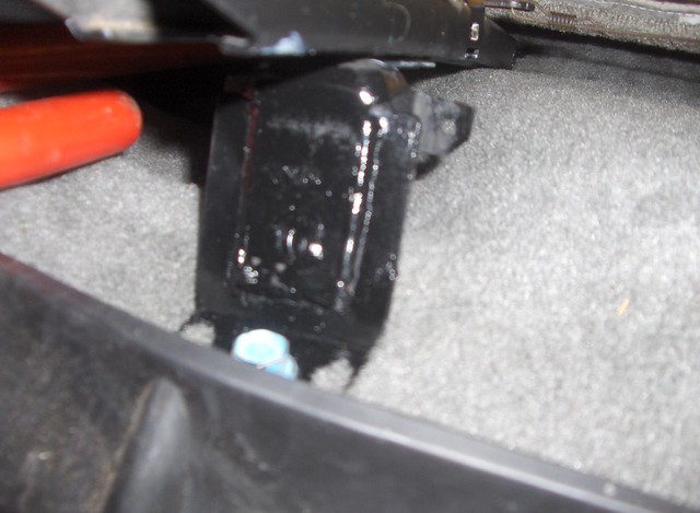

i have some pics of how i have done buckets in the past using stock bench seat brackets to start with .

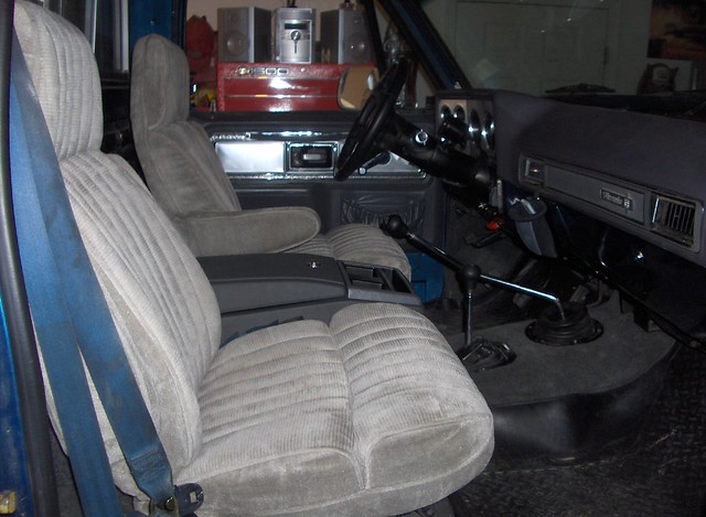

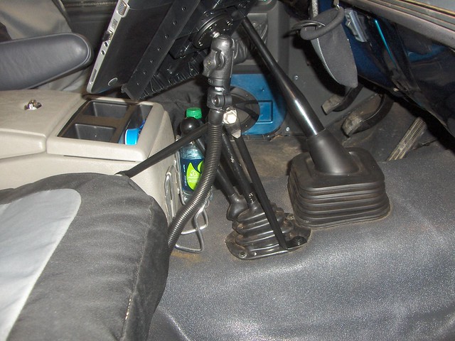

I have Blazer buckets and console in mine, Suburban brackets welded to the floor in the front. I didn't build it so don't know the details but could snap some pics for you.

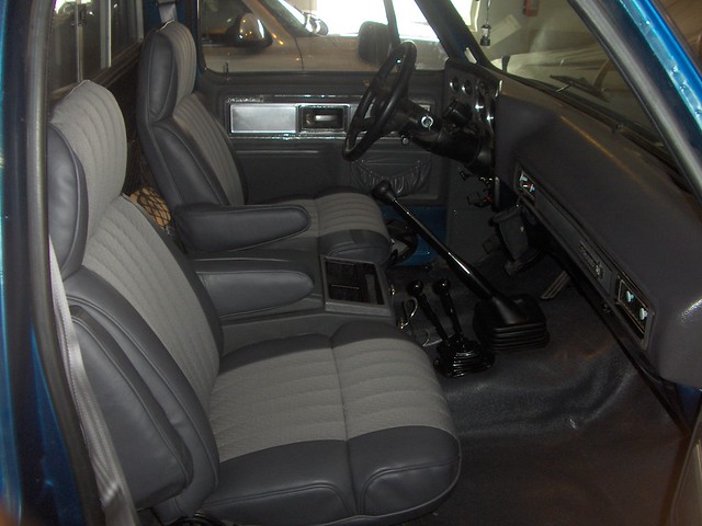

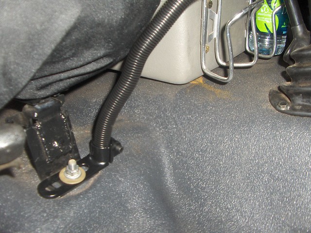

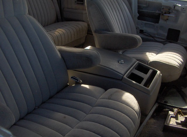

About 5 years ago I swapped out the front bench in my K10 for a set of 1989 Suburban buckets and center console. If I recall correctly, I used the outer seat brackets from the bench seat and the inner brackets from the donor Suburban. To mount the inner seat brackets to the floor I found an old Hi-Lift jack bracket that was lying around the garage that I cut in half and used each half to make the inner forward bracket for both sides. The Hi-lift bracket worked out perfect for my skinny ass but, I don’t think it would be very difficult to take a cordless drill to the bone yard and drill out the spot welds on the inner seat brackets from an actual Suburban to reuse on a truck.
The donor

The inner forward brackets
What I used to make the inner brackets :haha:
Had the seats reupholstered in 2010 when doing an interior remodel after a NV4500 swap
Before :rolleyes:
