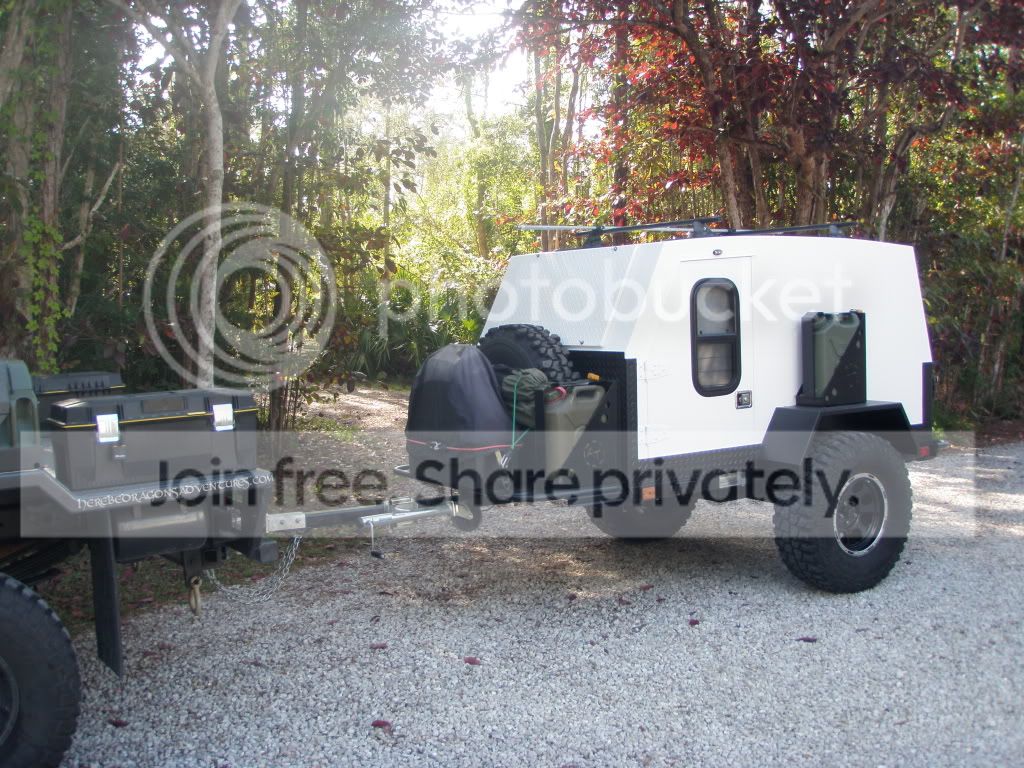

Here is the one im going to loosely copy

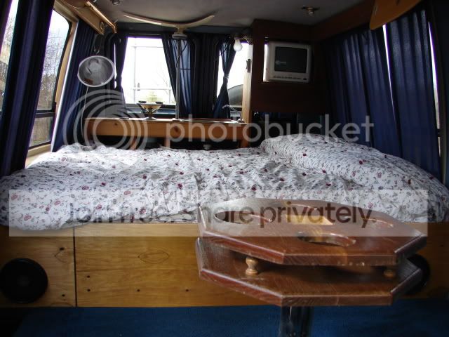

I am thinking about the same project. Do you have a web site link for more information about the trailer pictured. I have completed a couple boat and rv projects. Must haves on my list are a full size bed with head room, sink, one burner stove, and a place to be able to sit but standing would be even better. A picture of my van project is below.
