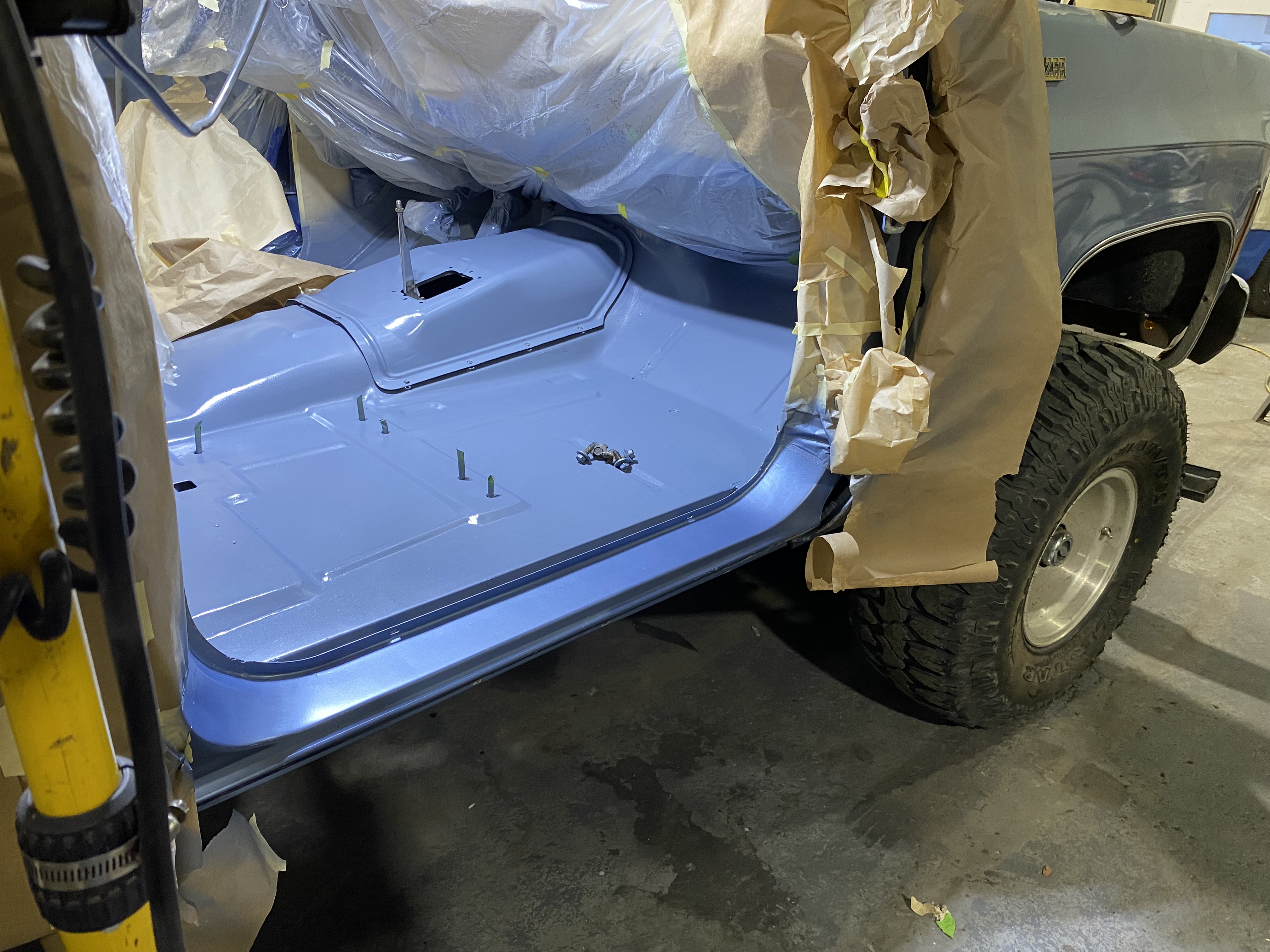

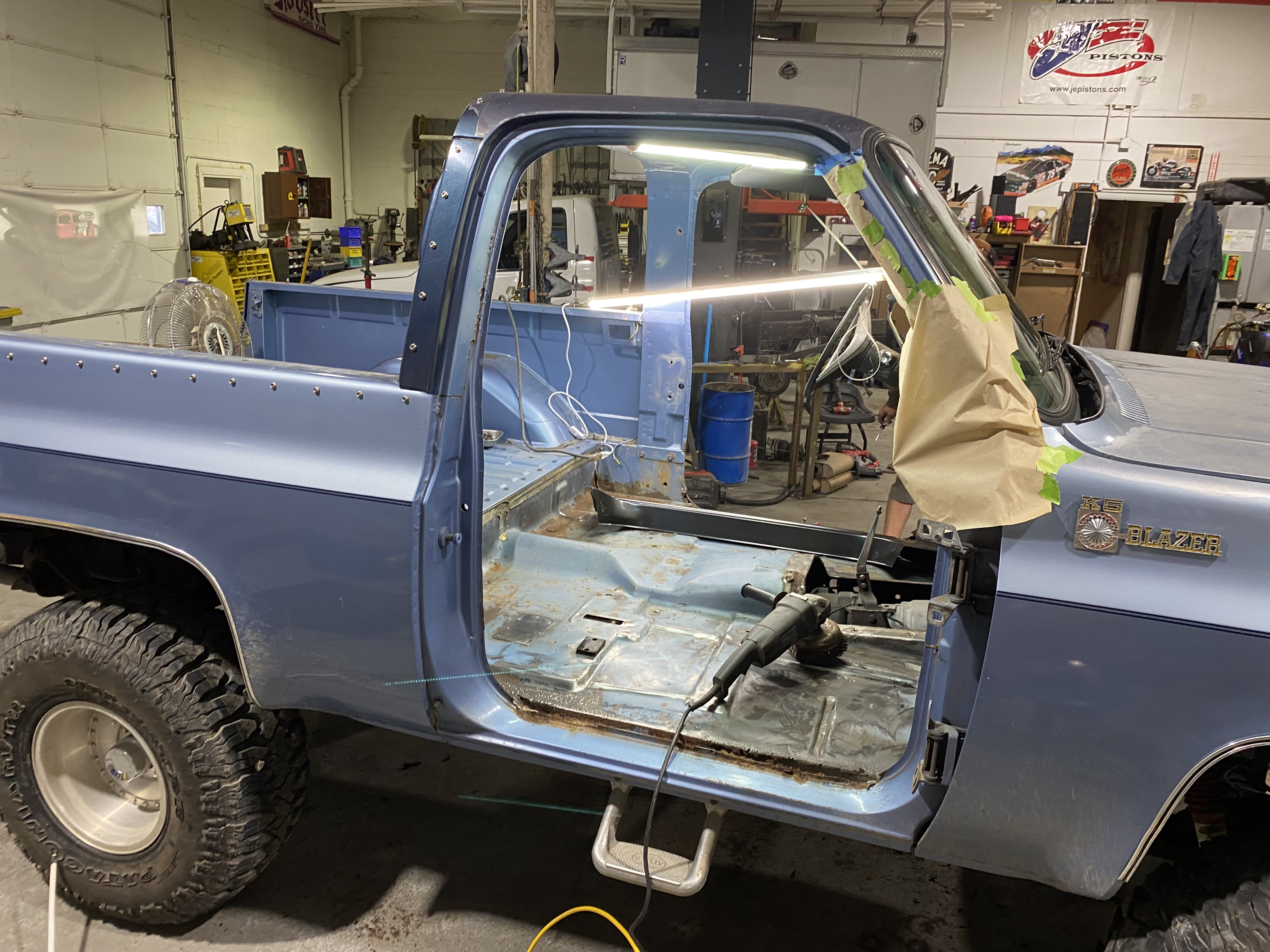

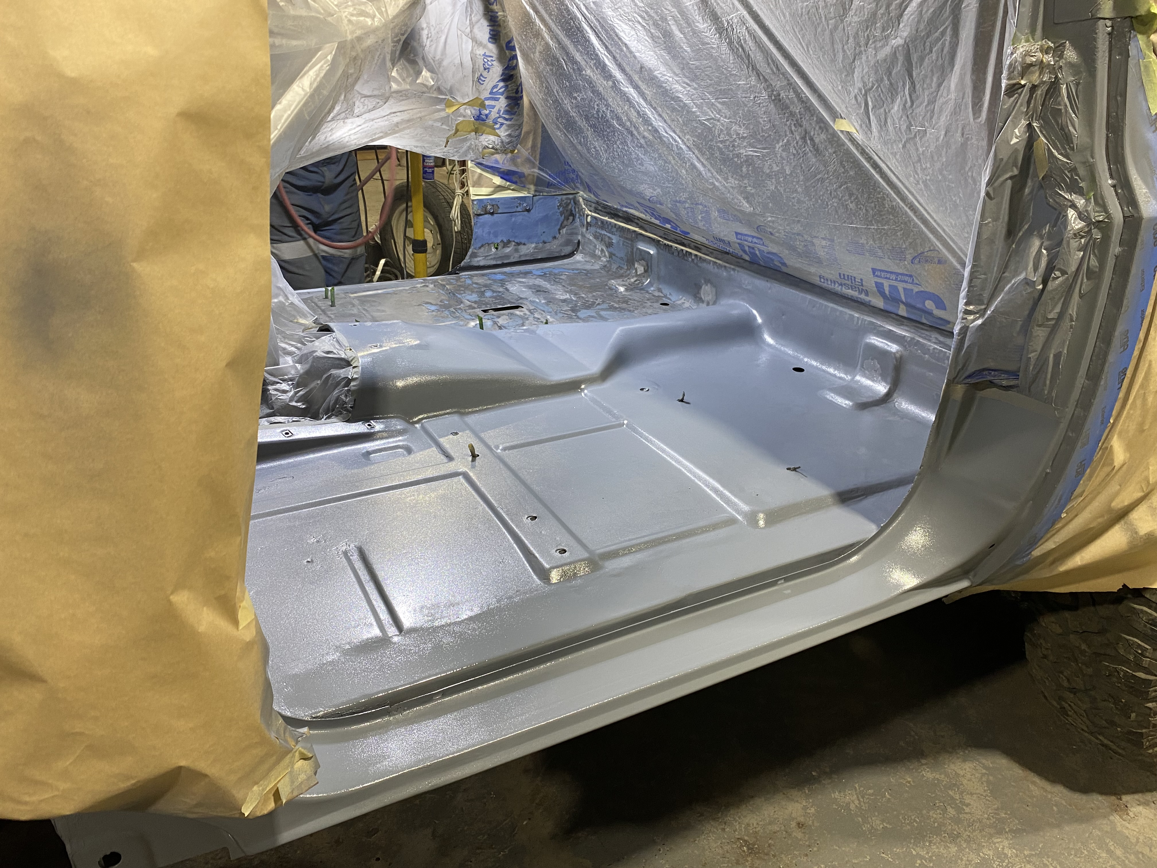

Fixed the drag link drove it for a week and then I tore it all down to do the dreaded rust repair

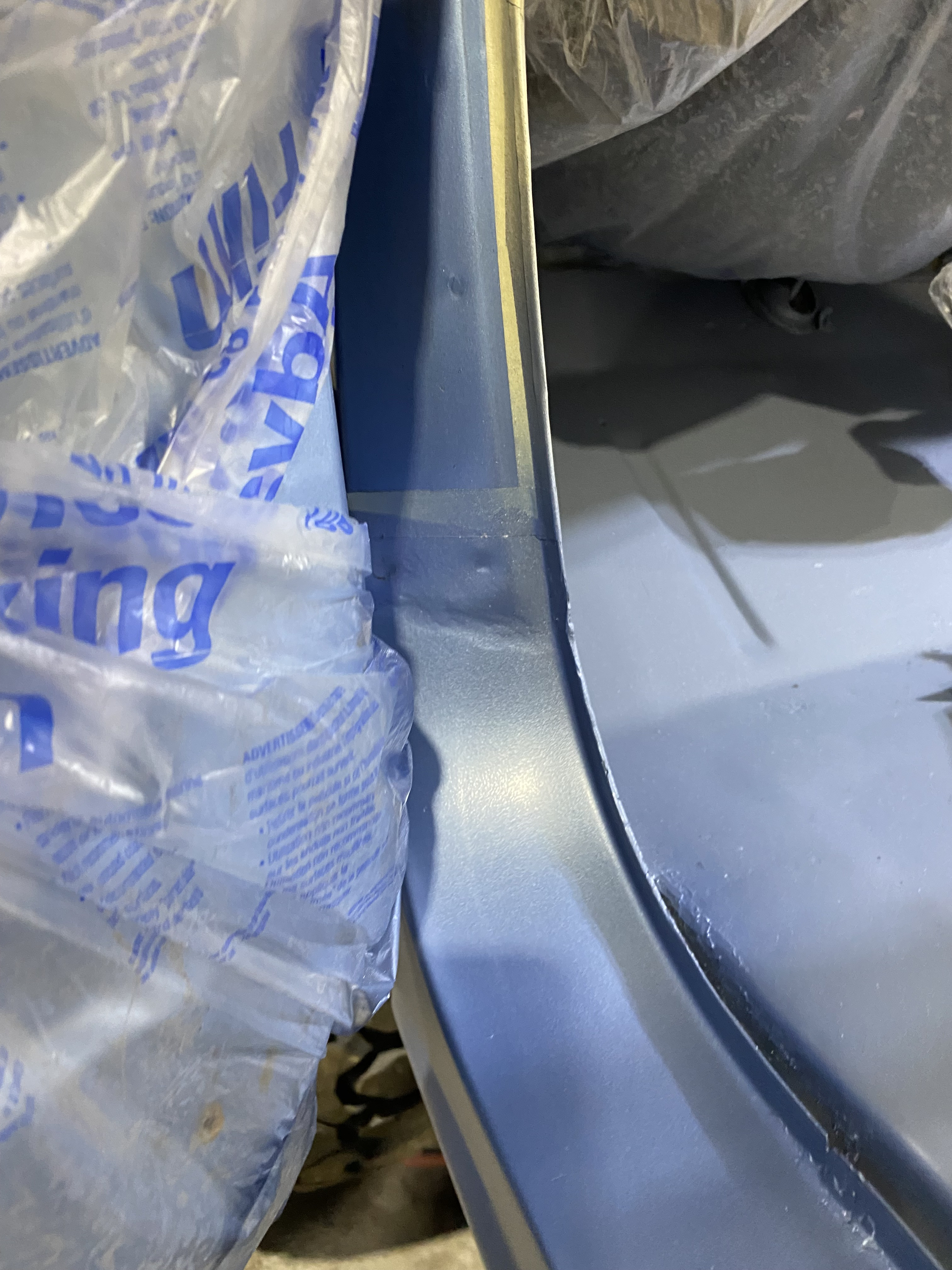

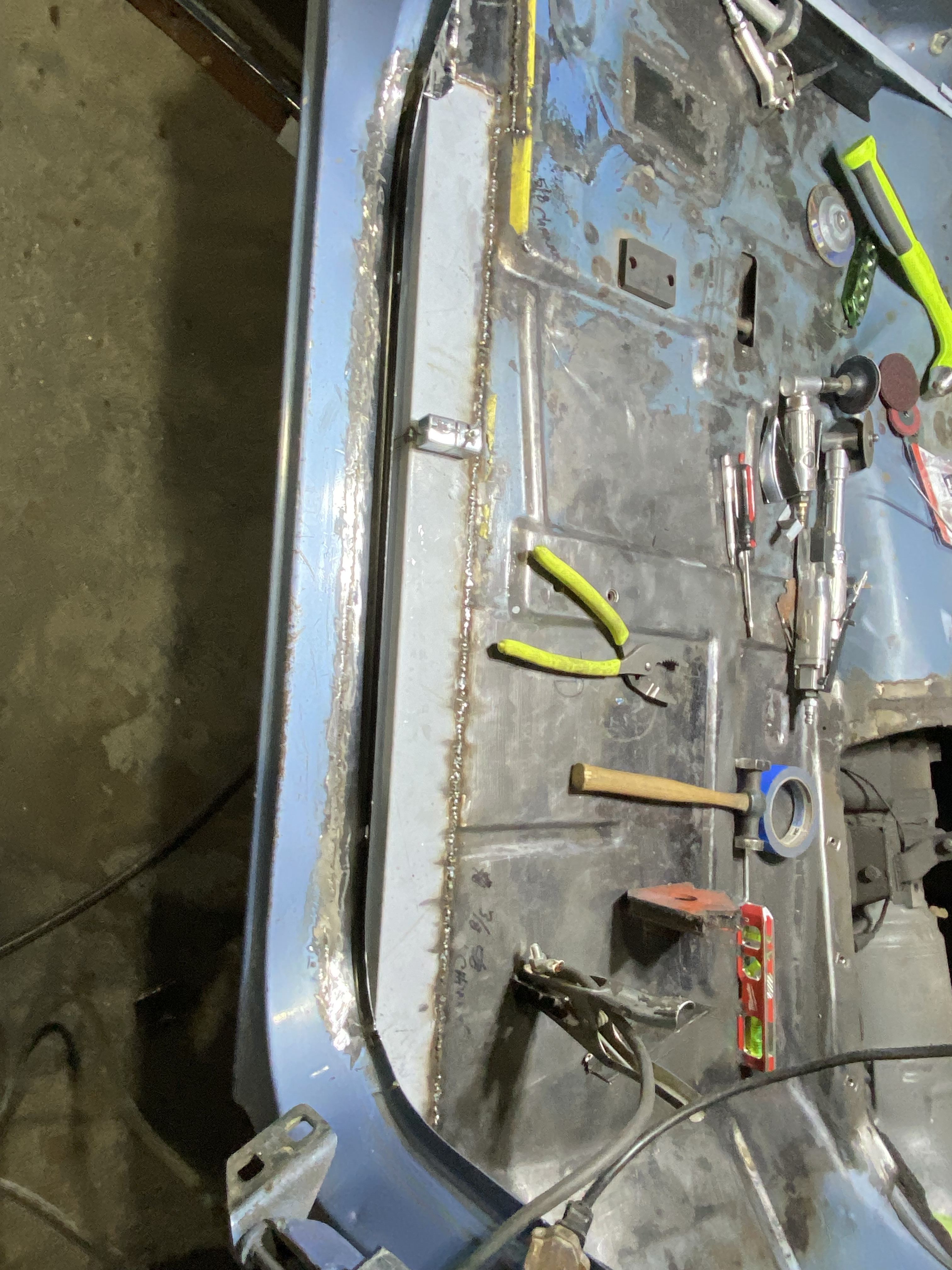

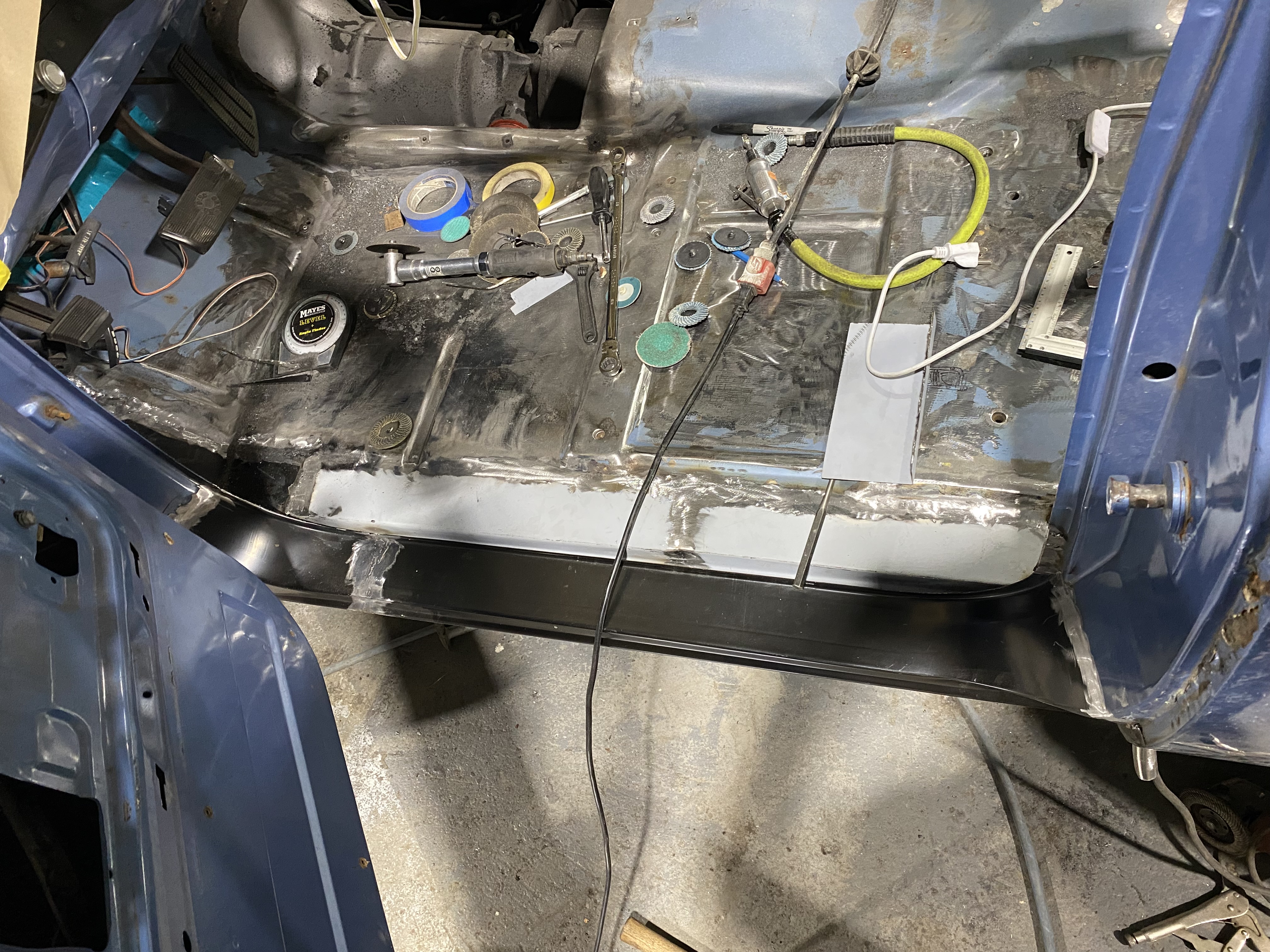

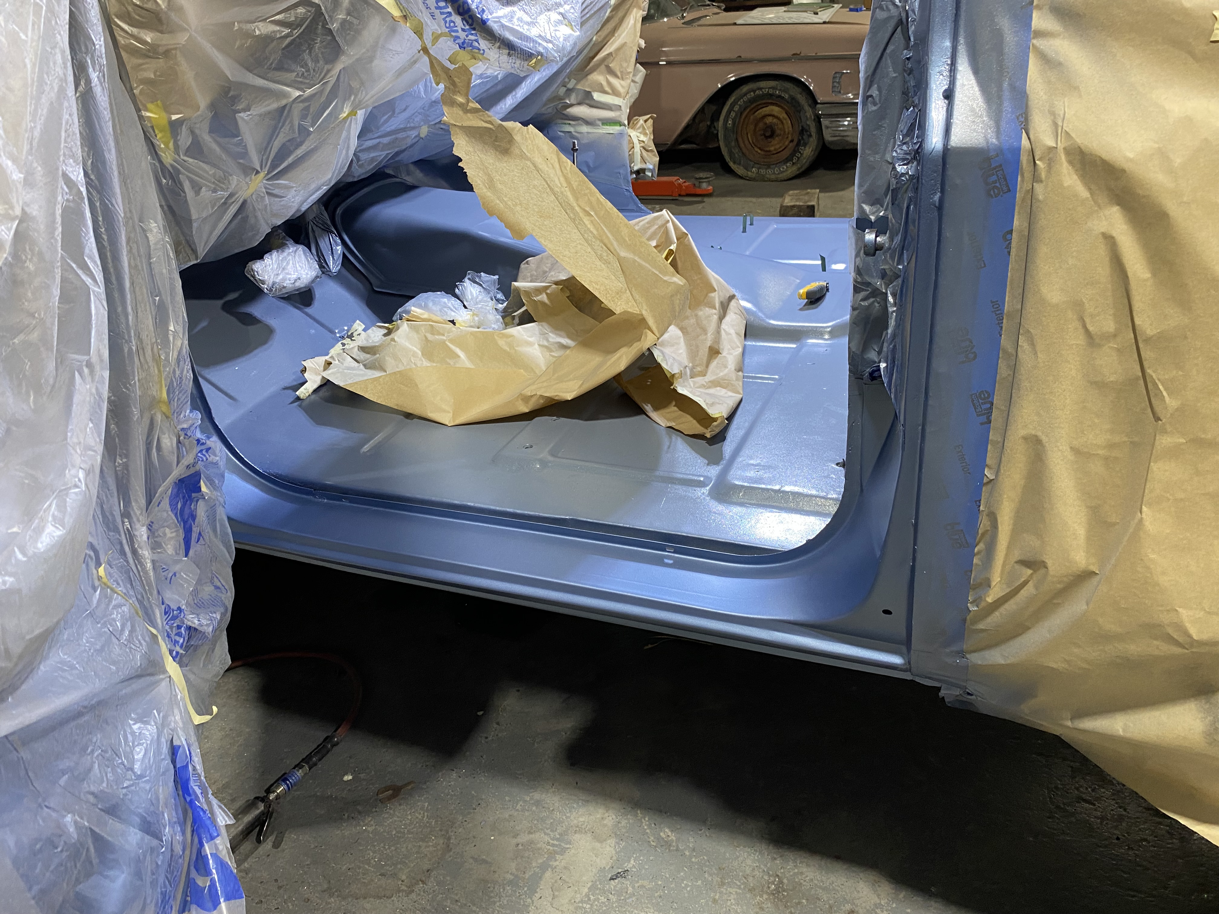

So patch panels for these rugs are really bad. Thin metal and nothing truly matches up with stock floors in blazer and the actual rocker ended up being about a 1/4” too short. The front inner kick panel was pretty accurate however the depth to the gutter that dropped down for the weather stripping area was also too shallow.
So we took 16th inch steel and sectioned it into roughly 10” and bent the metal in sort of an M with a true 90 in the center 1” sections.
This is better than any patch panel as far as creating a strong inner rocker that actually spans the distance of the floor. Best solution for out floor rust and inner rocker replacement.

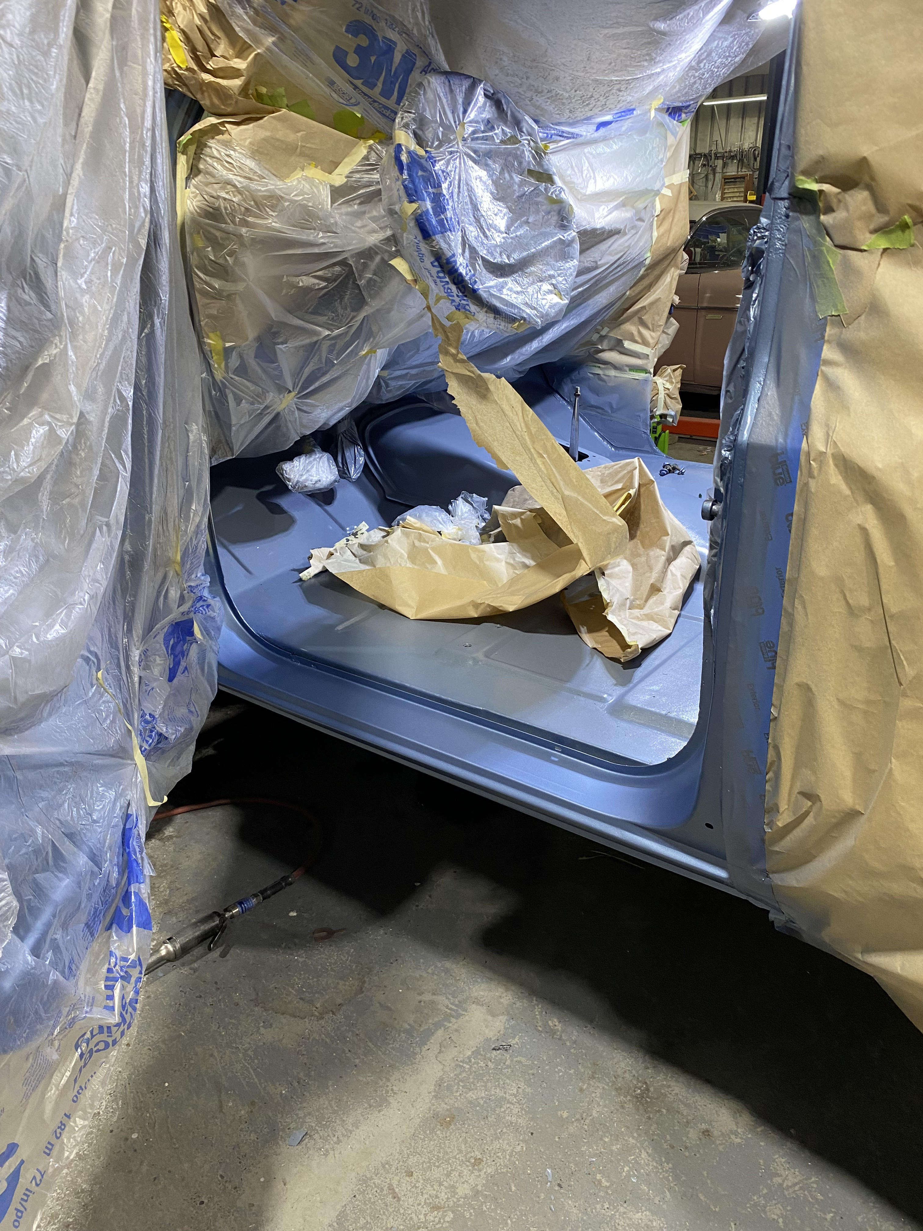

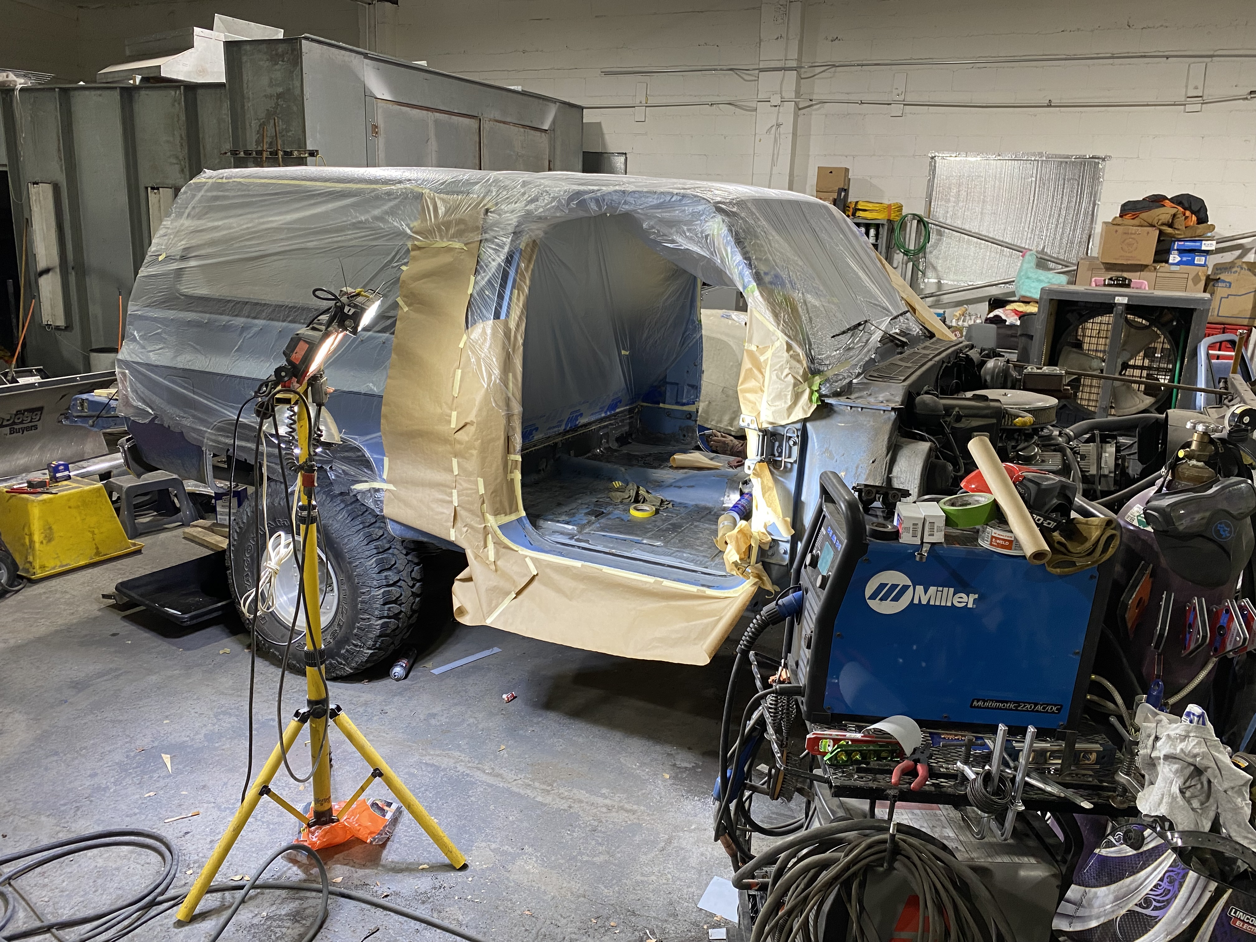

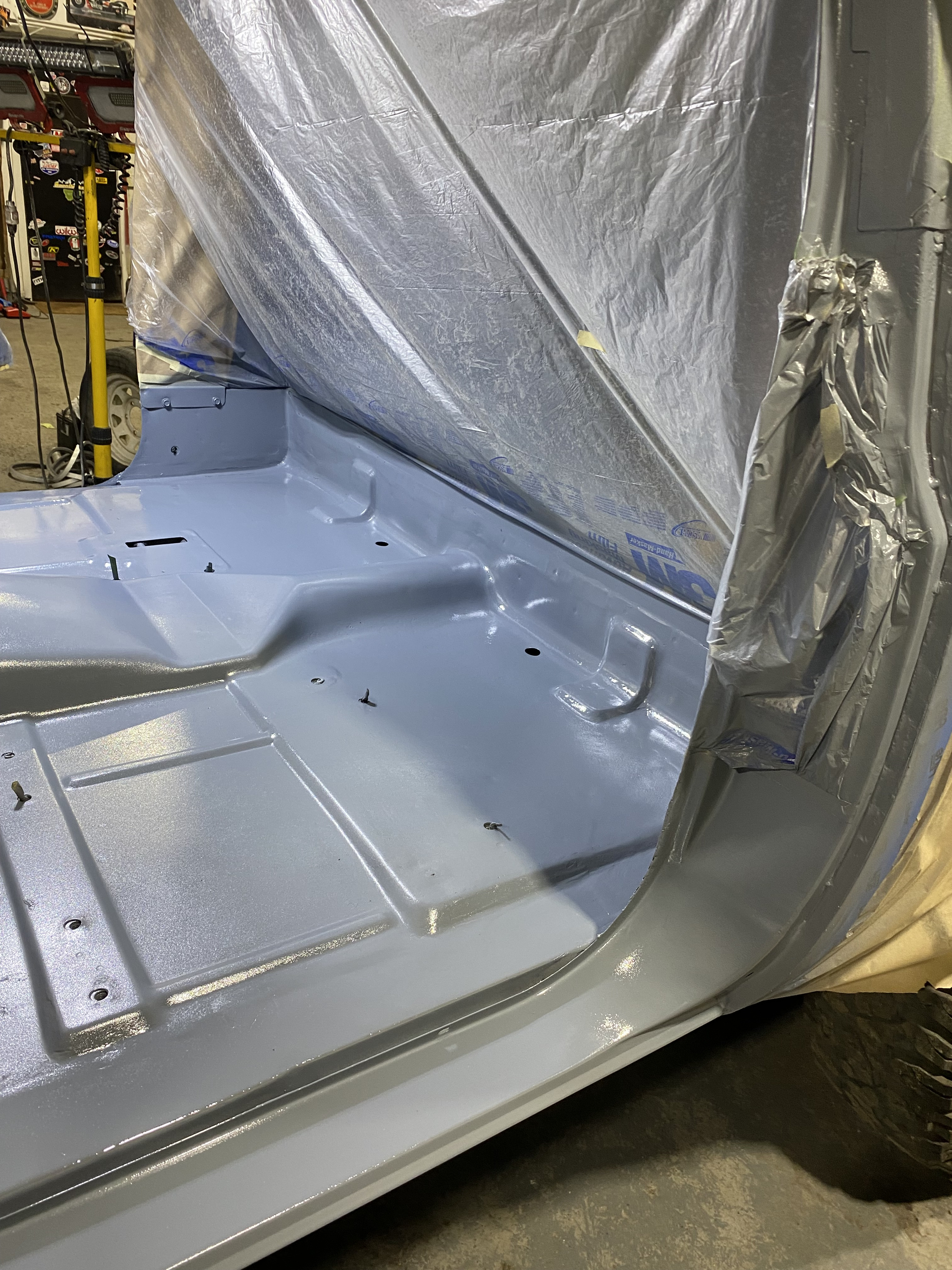

life took over the year or so. Finished up the blazer floors - a buddy of mine runs a shop in Billings, MT. William did a great job of getting the truck finished up. Reach out if you are in Montana and need any hot rod help engines to rust repair and everything in between- I will put you in touch with him.
You guys did a really great job with the rust repair! Most people don't go to the lengths required to actually recreate the original panels, how they overlap, etc. They just slap sheet metal over the holes and weld it in. And I don't necessarily blame them, especially with how many of the replacement panels fit (or rather, don't fit). But seeing work like this is very impressive. It's not easy and it takes a ton of time. Even looking at the bare floor pans under the carpet, it's hard to tell they were repaired at all compared to clean original floors.

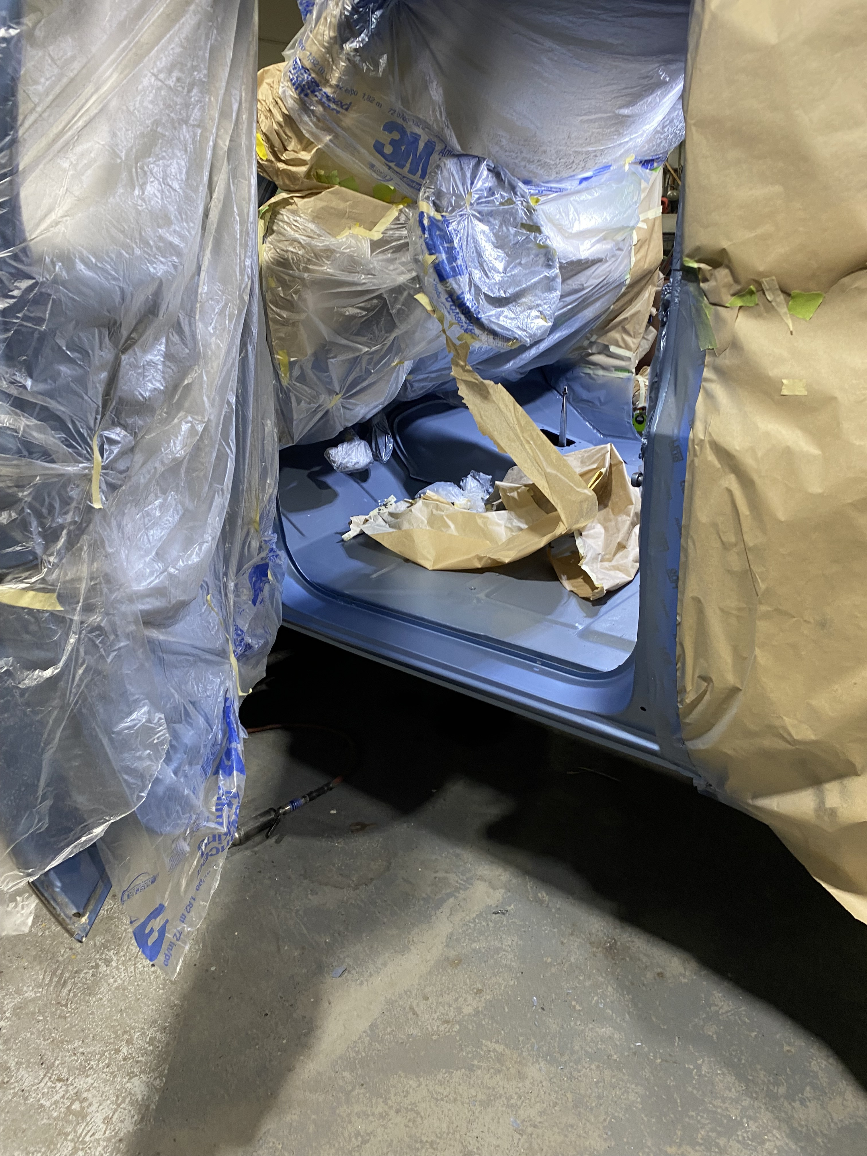

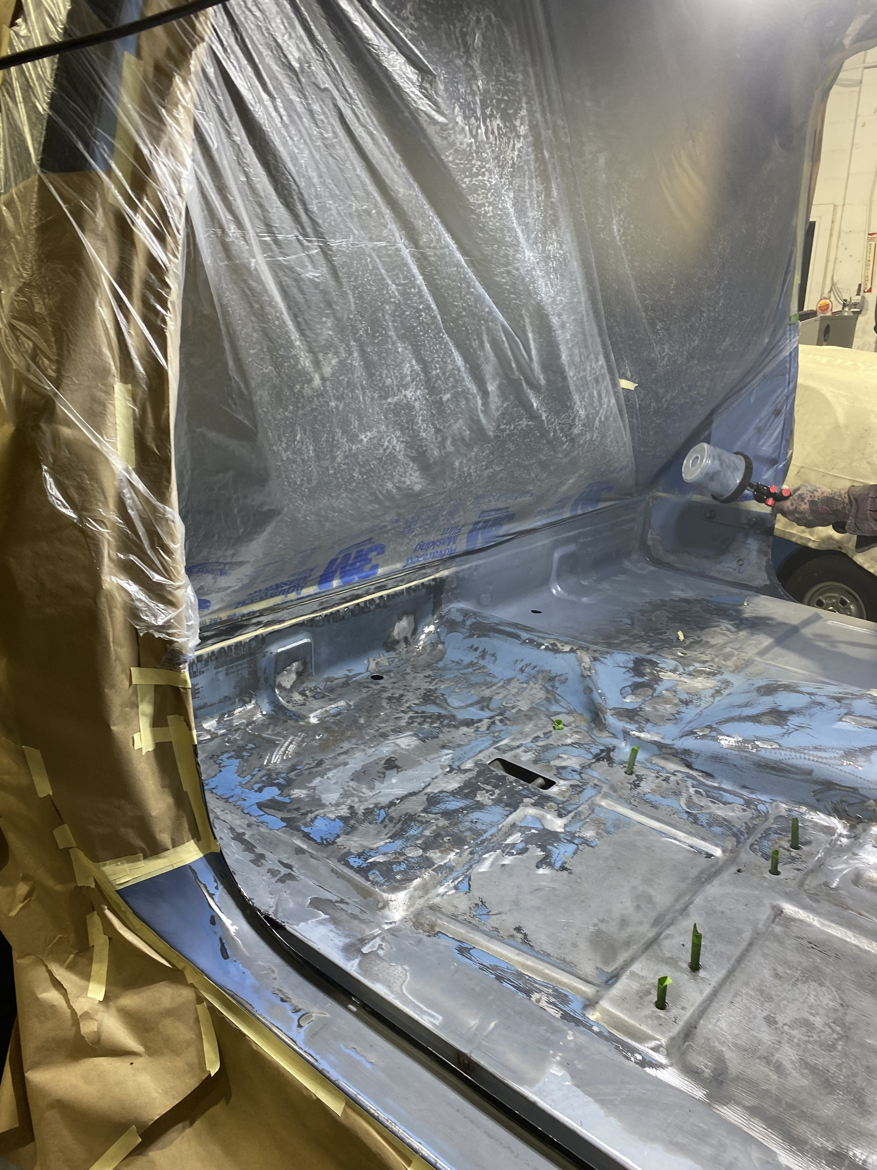

Thanks - my buddy William deserves all the credit! I learned a lot, and ultimately figured out that your further ahead to make your own patch panels. I Bought all the junk aftermarket crap pans. All garbage! Lost a lot of money buying those and non of them are designed for the blazer. We decided to use a metal break and I believe 16 gage metal? Took the floors down to bare natal, acid etched and automotive primer. Then had a close match to the paint blended and sprayed.
