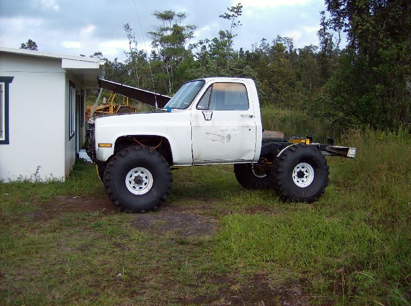

Things snowballed. At least it's not a crew cab on mogs.
Picture doesn't do it justice. I built myself a huge ass truck. Should have sheetmetal on it tomorrow and outside of the shop for pics that really show how big it is.
42's TSLs
it doesn't look that big. the top of the tires are still above the rockers. 42's are nothing anymore. but if this was built from your old rig in your avatar I'm sure it seems huge. I remember bolting on the 44's for the first time. I couldn't stop giggling and muttering to myself that it was stupid big.

I was/am the same way. I knew it was going to be up there but dammit man. I didn't realize it was going to be THAT big. I'm still giddy, lol. Looking good though! :waytogo:
Maybe it is time to change the specs of the M-1028 in the sig :wink1:
Looks good BTW :bow:

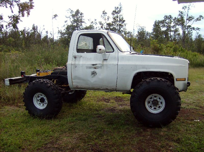

56's all around. The fronts are from a m1028 cucv, now 6 leafs, every other leaf removed from the original pack, zero rates, 7" shackles. Rears are the same packs, but only 4 leafs total, no zero rate.
I'm happy with how how low it is, I'm just going to have to limit up travel significantly.. which is alright, the leaf packs are almost flat as it sits.

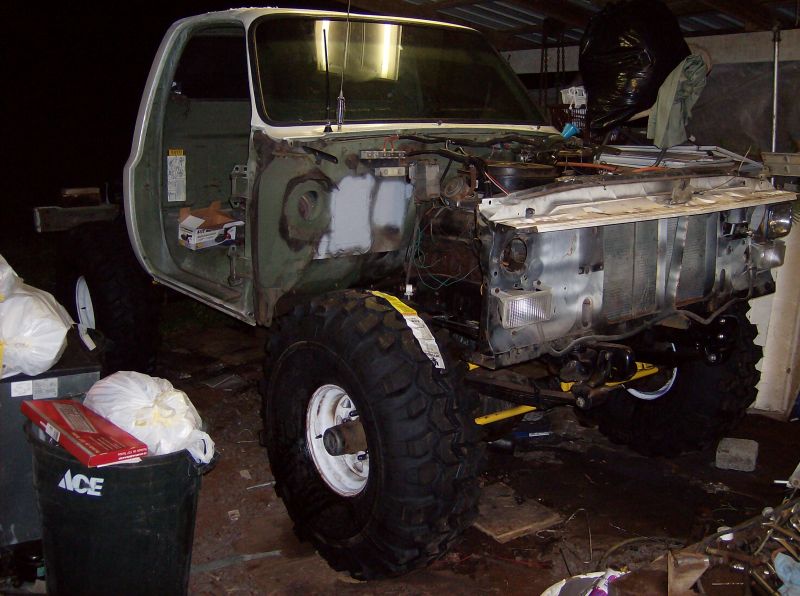

More pics too, put the doors/fenders on tonight. Had to trim the fangs just a little bit to even get the fenders on the truck at all!
Dam now that's BIG. In the first pic, I was thinking nah, not big, just right. But then you added the sheetmetal, I thought WOW! You might not even get any uptravel at all, if you're lucky, you might even get 2 inches. Looks good though :waytogo:
Even these pictures just don't look as big as it looks in person. I think I need to get a picture of my standing beside it. I can sit underneath the truck.. hunched over a bit, but SIT under it. Oil changes are going to be difficult, because I will need to compensate for wind blowing the oil as it falls 2 1/2 feet to the bucket.
