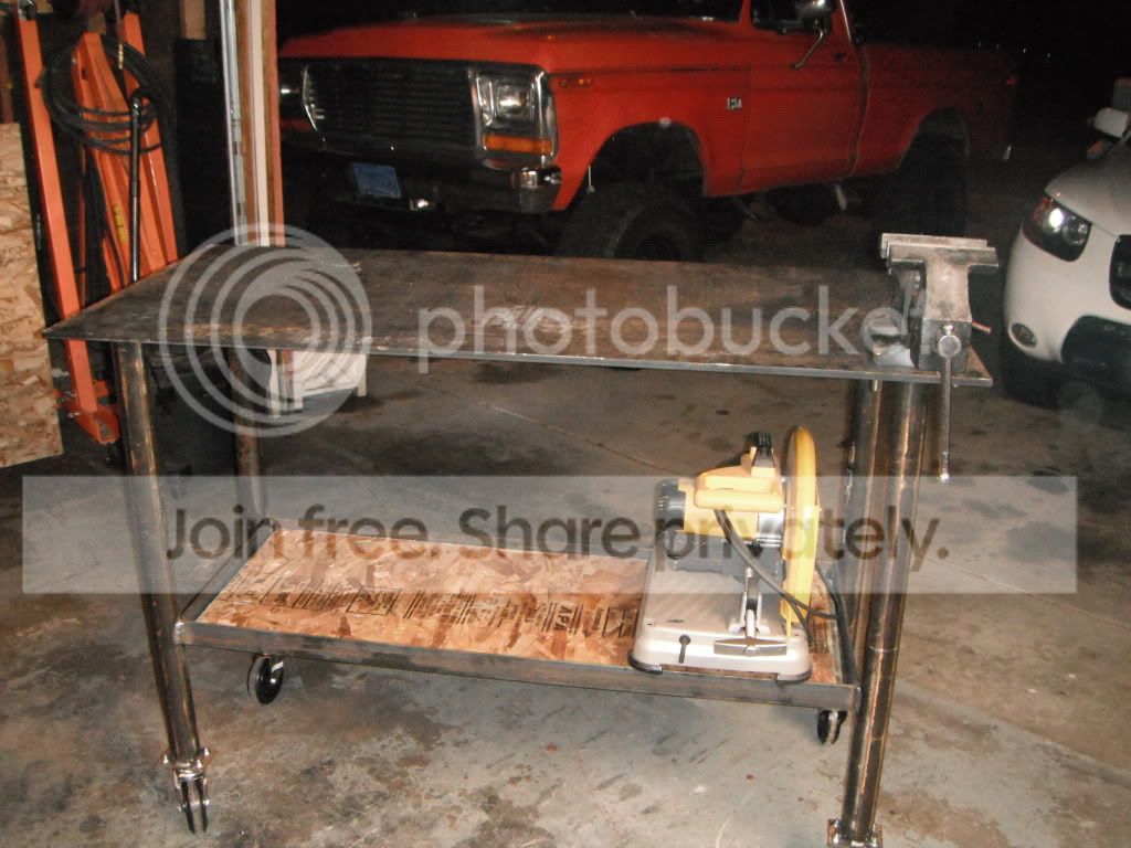

I have been needing a new work bench for a while since I re-arranged the garage and the old bench with it's particle board top got axed.
I decided this morning to make it happen so after a quick run to get material I got to work and came up with this. I think it's about as simple as they come but it serves my needs. 1/2" top (weighed 240lbs on it's own) and 2" sch 40 pipe for the legs.

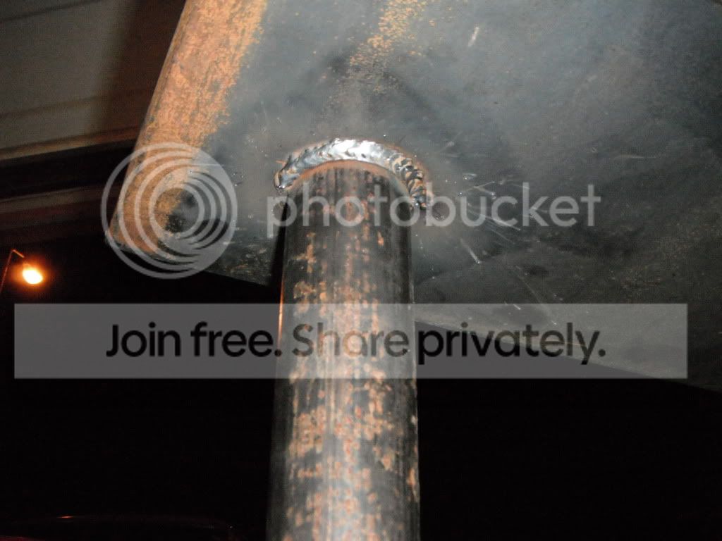

I was happy with my welds on the legs so I snapped a pic.
Sweet, nothing like having a SOLID work bench. What are the dimensions of the top and how much did that plate cost?
It's 5' X 2'-6"
The girl sold it to me as rem @ $0.65 a pound for the top. So it was about $160 for the top. With everything I'm into it for a little under $300 and I have a bunch of the pipe, angle iron and flat bar left over.

Looks great man. I have a 1/2 steel top table too, love it.
a mobile workbench is great. I move mine around a lot, only problem comes when you need to torque on something heavy in the vise....it tends to push the table around.

He measured it and the hitch on my dodge lines up with the lower shelf on the bench. He said why can't you just weld a 2" receiver hitch up under the shelf and then make a piece of 2" square tube that would slip in the hitch then slip in the one on the bench. It's not often that I'd need something to hold the bench down but if I ever did that just might work.

As long as you only need it anchored when you aren't working on the truck, sounds like a good plan. But you'd be amazed what the increased leverage will do if you happened to have the front on stands or something. Wouldn't want to risk anything like that....
