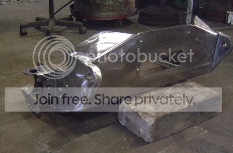

Mudder: it is foot forward, why do you ask?
Jek: it really doesn't stick out that far and I don't think it affects approach angle either, not like some typical winch bumpers that I have seen.

I was just wondering how the winch mounts, cause it was kinda hard to tell in the pics i have seen. This will actually work out better for me because I'm using a warn winch with the integrated solenoid pack so now the winch will be leaned back and the solenoid pack won't be in the way

When you get into the 12K's the foot has to be forward. Ya can't trust the bolts to hold it anymore. The smaller ones can be mounted either way according to the warn manuals. One thing to watch is the clutch handle and how it will be positioned. Some can be clocked some cannot.

My clutch handle can be clocked, so I'm good. Kert I'll be giving ya a call this weekend. I also need some bushings for my flatbed mounting and my brother needs some stuff, so were are going to get a list together and just put it on one order.
maybe my frame horns are different (diff year?) or maybe I have trimmed them some... but it looks like that bump sticks out at least 6" further than the end of the frame horns. The top bolt on my set up is purdy close to the end of the frame. :thinking:
I understand why it is that way, its just not where I want it for what I'm doin'. :thumb:
