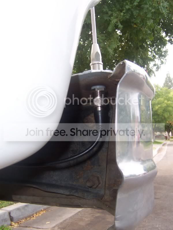

your best bet would be stainless 102 whip (they dont brake) mounted on the bumper. no need for the quick disconect, and can bend over to clip to driprail for the garage.radio shack carries the whip , spring and base you need..

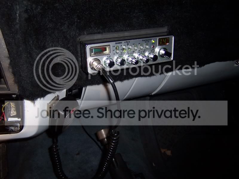

I run a Uniden CB and a 102" SS whip on the rear bumper with a little nylon washer to isolate the antenna from the bumper (this old picture shows it below the bumper but now I run it on top) and after a quick tune-up at the local CB shop I can talk for miles and miles...
When we were in the dunes last time I had no problem talking to guys 5 miles inland and I was out in the middle of the sand so I'd say it works.
Like ghostrider said Radio Shack carries the 102" SS whips for cheap.
