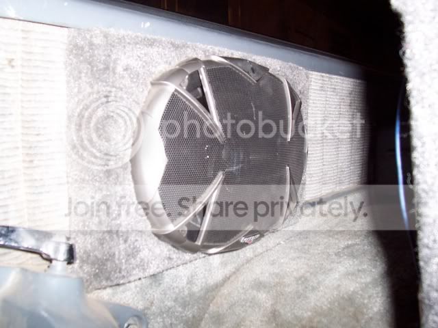

I mounted a pair of tweeters in there, yes it does sound good in there, the reason i only went with tweeters is i needed more high end after the 1500 watt amp was installed that is pushin' the 2- 15" Kicker Comps :tongue1:. The side factory 4x10 locations were opened up a hair and a adapter type plate made to fit the larger 6x9's.

Build a plate, and put them in the stock side panel locations. I have some high power 6x9's back there, running 100watts a channel, and you'd be blown away by the low end they are capable of. 6.5's will soudn good in teh right location, and will benefit from the "sealed" sort of enclosure the side panels provide.
6x9's in the factory side panel locations, they are deeper than the stock 4x10, so this plate made of wood and carpeted was fab'd up to make it fit.
And yes, they sound good, using that whole side panels as a makeshift enclosure.
