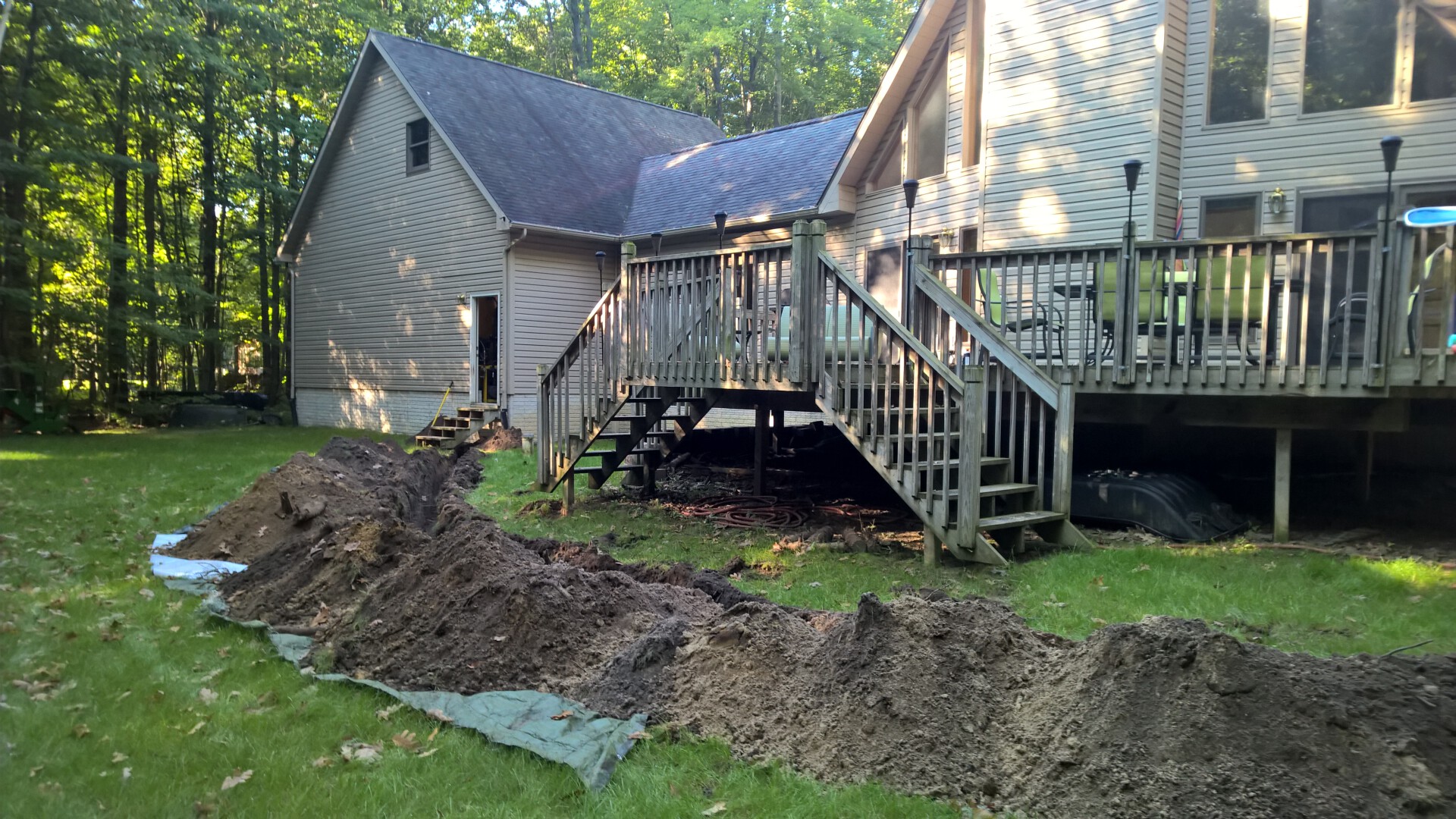

I figured, I'd give it a shot. I have a back hoe, the whole side yard was already tore up from pool removal and some other stuff that was happening over there.

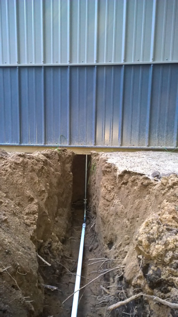

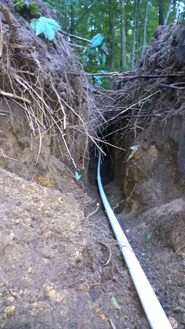

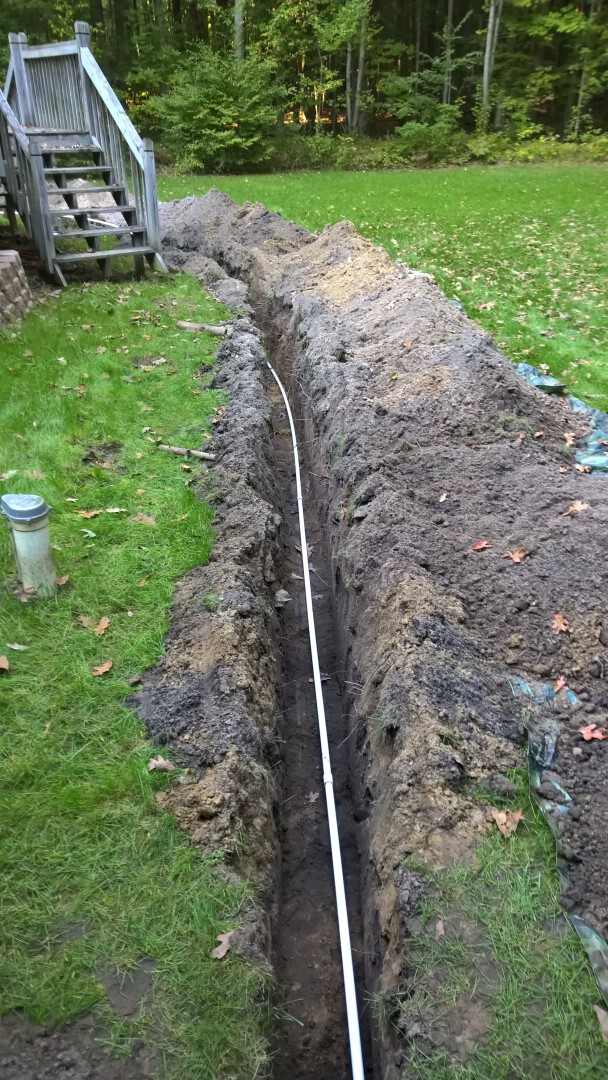

It's about a 250' run. I bought some 1" sch 40 PVC, 450psi rated, I'd never use it in a shop, but buried...it's cheap and safe. I dug a trench which has a 5' in the middle, and slopes gradually to the garage and the barn. It's about 3.5' where it will turn 90 and enter the barn.
Man, that's a giant long trench. In the 5' area, I'm in the water table, at this time of year, that's crazy high still. But, oh well.

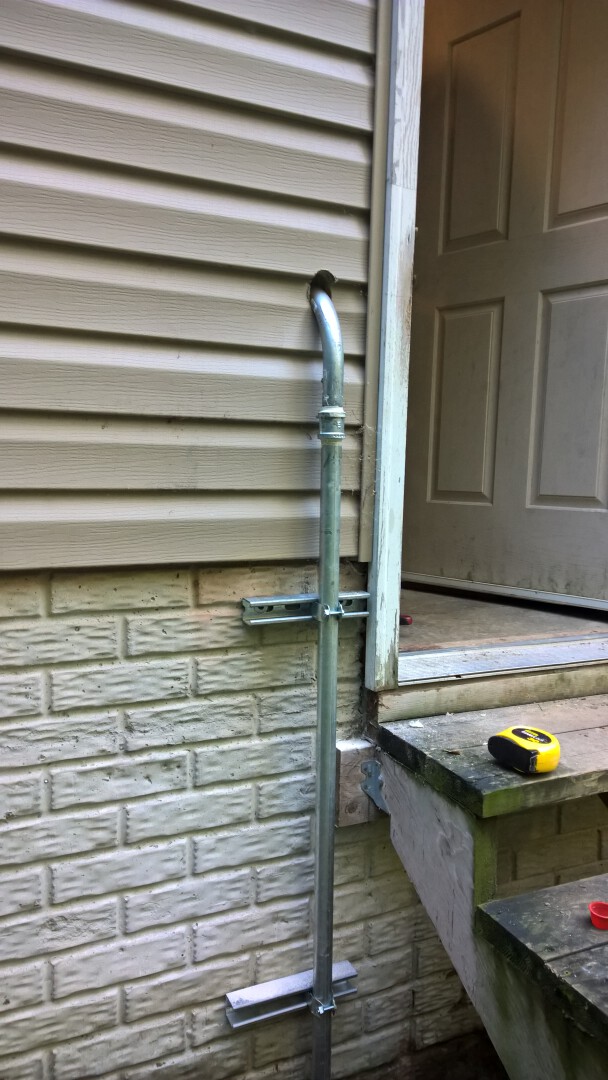

I thought about putting drip legs and condenstate traps. That really complicates the whole system and adds alot fo cost. So far, with all the PVC, fittings, galv. water sweeps and verticals, and 2 ball valves, I'm in for $100. For $100, I figured I'd try it, if it doesn't work, oh well. My compressor has a little service tank and for the most part, I pressurize thhat 240gal tank to 160 and don't need to run it for a month, unless I'm doing something intensive. I can add a dryer on the line, but I've never seen water in my drip legs in the shop, except the one directly under the compressor, and then only when it was ran.

Well, I had already dug the trench when I originally posted. So I went thru with it. We'll see how it works. It's average depth of 4' down, some of it 3 some of it 5.
I think it *should* work ok. I have a 240gallon air tank, and my compressor only runs once a month, unless I'm doing something heavy. So I think for the most part, most air being used will be at ambient temp, not hot from just being compressed. Ground temp at 4' is around 49 here, and can swing abour 8 degrees from summer to winter. So, I dunno, but I'll find out!

She's all buttoned up and filled now. Just a little 3' wide strip across my lawn I'll have to plant. Most of the trench went through woods and the side yard where the pool was just taken down, which was already all tore up anyway. I'm glad I put tarps down in the lawn areas, while it was a bit more work to get the dirt back in off the tarps, it really saved the grass for another 6' wide.
