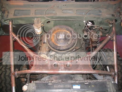

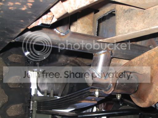

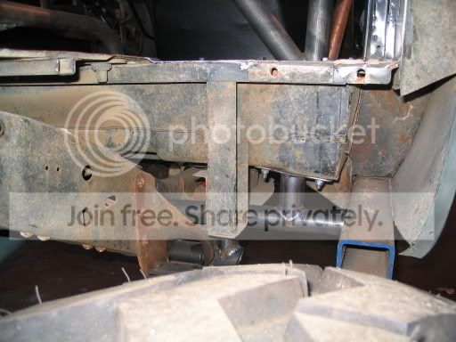

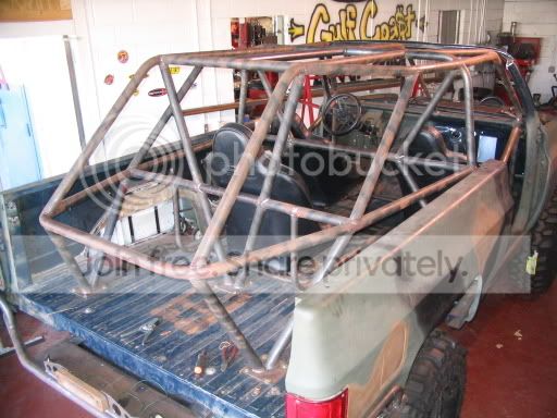

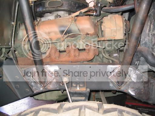

I just welded mine to the frame, then have sandwich plates at the body. My body does not move one bit.
