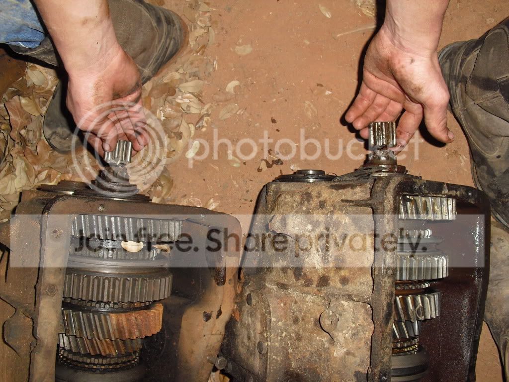

I guess i need to pull the 540 out & put a 22re in its place. All this parts breakage is getting expensive. Last time it was front axles & the front detroit. This time:
Dana 60 ring & pinion
D 70 HD rear shaft:
Yep 42" TSL's. Bad thing is they both broke within 10 minutes of each other. I broke the shaft in the V-notch on top of the Outlaw trail at Superlift ORV. backed out & tryed to take the bypass. I broke the ring & pinion on it.

Im breaking the same parts. 2 sets of Dana 70 rear shafts, Dana 60 ring gear, one front shaft and one broken inner knuckle. I just broke my 2nd TH400 case last weekend too.

Those break too. At least the 465/205 adapters and power sleeves. I have a fix to beef up the TH400 cast aluminum cases. :thumb:
