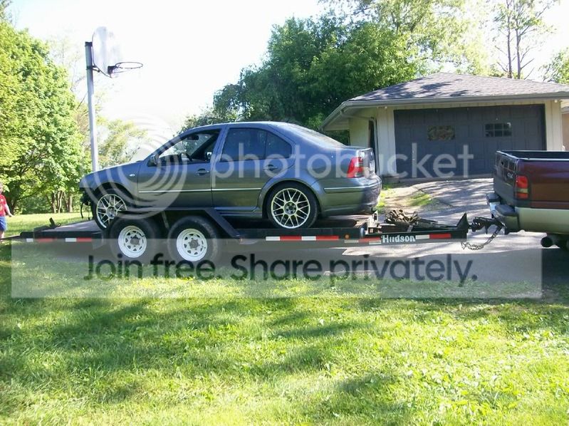

Another thing to keep in mind when looking at load cap's is, you have to take into account the weight of the trailer as well. For example, I own a Hudson 10k tilt deck, awesome trailer, too narrow for fullsize trucks though :(, the trailer weighs approx 17-1800 so you have to subtract that from the total load cap. Meaning my 10k trailer is maxed with a 8200 lb load on it, or overloaded by almost a ton if I put 10k on it.

Here's a pic of the Hudson 10K tilt I have with my brothers moterless Jetta on it :rolleyes:
