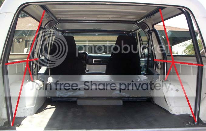

This is kinda what im going for. The red angled bars would go to the b pillar tie in, not to the fender well.

Also what do you think of that design i posted for my purposes? Prolly a few more gussets, and another bar up top, but basically the same.

I don't like the cage above. No triangulation in the roof. Large unsupported spans.

As I said, I would add some tubes to the roof. Other than that, I like the simpleness off it.
I want it simple as possible. Least amount of tube. I dont wanna get nuts with it. Make it a bit safer, but more importantly make it a strong tie to the frame so that I dont bend the thing up on a hard hit.
Couple triangles in that thing would be nice cage. I like clean looks too

Cool. One thing I noticed, actually like alot, but not sure if its a good idea.
See how the front halo ties into the plate gussets on the upper corners of the b piller?
I like it becasue it means you dont have to do any weird offset bends. I will problably add gussets to every single corner connection fyi.
Any input on that?
Something like that is fine when working in the confines of a vehicle things rarely line up like ya want.
