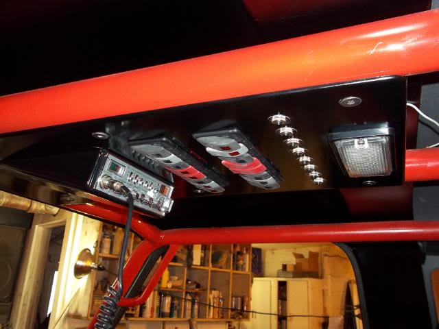

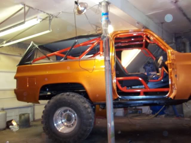

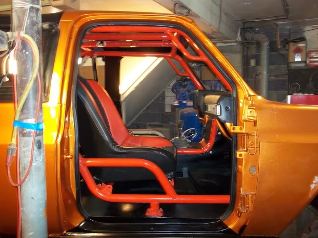

There are lots of threads out there on this, so searching around would probably get you what you need, but in the spirit of photobucket ruining the internet, here are some of mine
Do you have any problems with that A pillar in front of the dash? I don’t want to have to cut up my dash for a cage.
I don't cause I'm not a tall dude. I'm only 5'8" tall (and one of the tallest in my family), so for my situation it's not a problem at all. Some of the taller dudes can't stand my cage, but I could care less, cause it's my cage, bahaha. I could have gone a bit closer to the dash on my A pillars, but by putting it where I did, it made it a straight shot down to my slider supports that go to the frame, making it stronger. So it was a little bit of a sacrifice. It's not a problem for me, and I was glad I didn't go through the work of going through the dash, cause that adds lots of time/work to an already time intensive project
