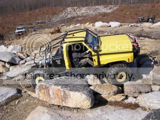

Heres mine though.
Sweet KTM...looking good. Looks like you are doing what I am thinking about...going to link mine with Kings all around. What kind of travel are you getting in the front and rear?
Not bad at all, you get any driveline bind at all because of all that travel? Did you lengthen the wheelbase? Thanks...I might have to email you later for some details if you don't mind.
Hey twoslo...I am actually trying to build something that will do a little of both. Hi speed desert and some trail running too.
Had to do a little clearance work on the front CV joint. Very little. Back is no big deal. The SYE was added with a NP241 to keep from destroying another 208 out put housing.

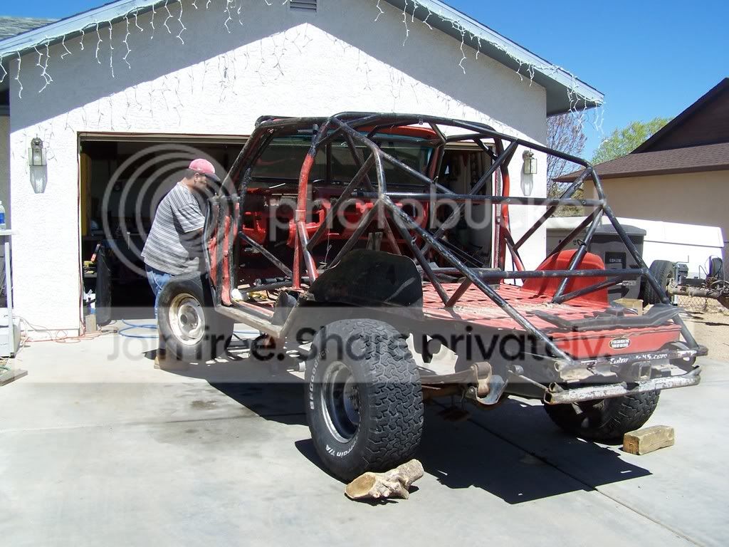

Thanks so much guys. Very sweet rdn2blazer...looks like you have a lot of hours in that tube work. I did a little mini cage in my old Grand Cherokee for the rear 4-link. Was going to do a full cage but then sold it :(

Thanks man, Yup, alot of hours for sure. If your ever in the neighborhood come by for a beer, you can take a look at it in person. Just PM me anytime. Would be cool seeing your new ride too.

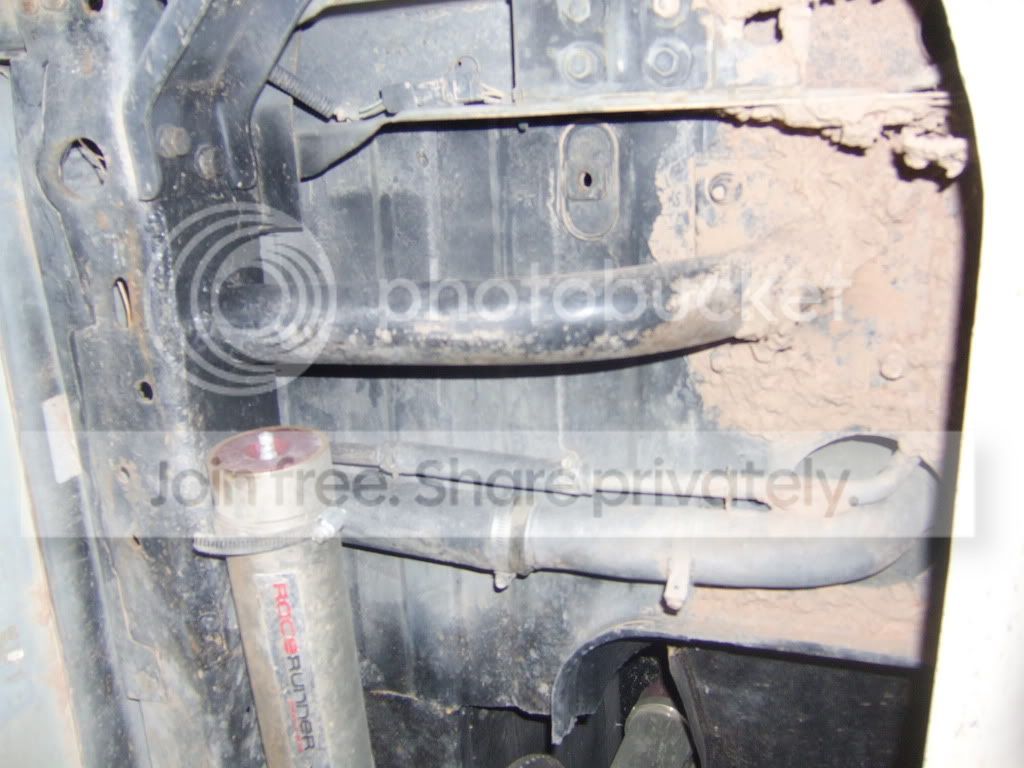

Now that it is no longer driven on the street I will be adding some more tubes and gussets. I also plan to move the seat belt mounts on the bottom. They are ok for me when the seat is all the way back but for Donna and the kids the angle is a little much with the seat forward. It is tied to the frame. The sliders are tied to the frame in 3 spots on either side and the cage is tied to them. The 2 rear mounts are not tied in to the frame yet. I will do that after I install a fuel cell in the back and do some other work to it. I also plan to eventually hack the front off and go through the dash and out to the front.
