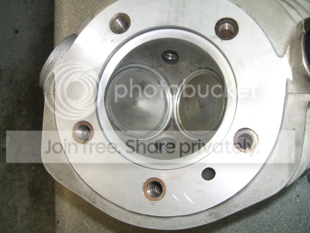

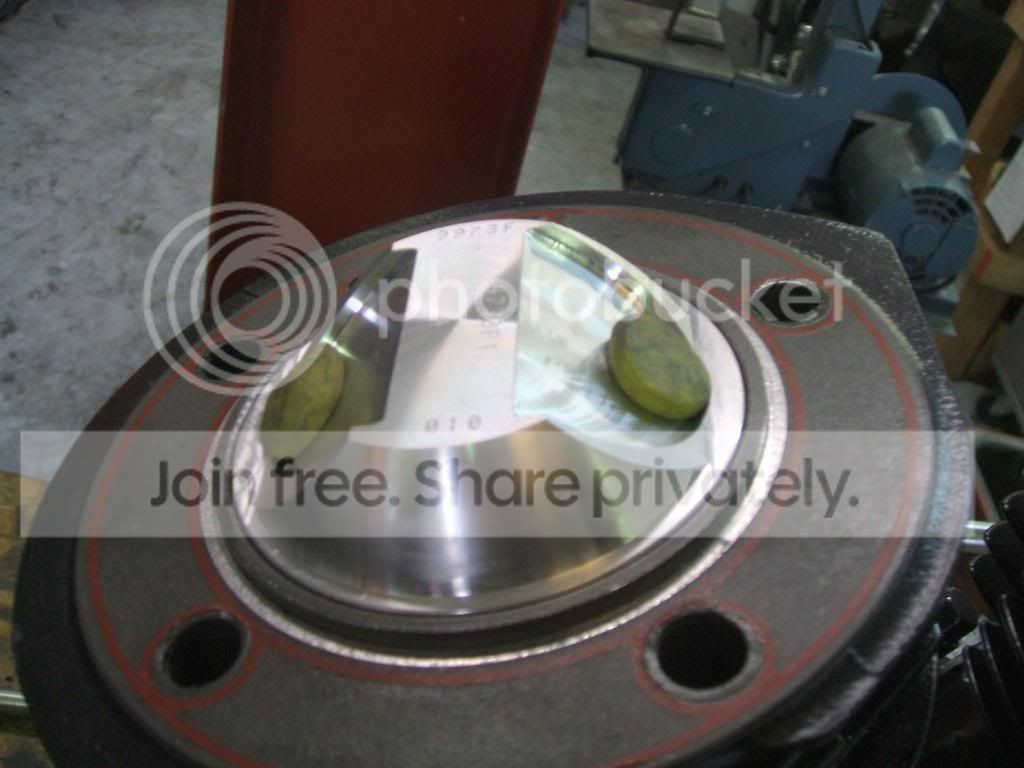

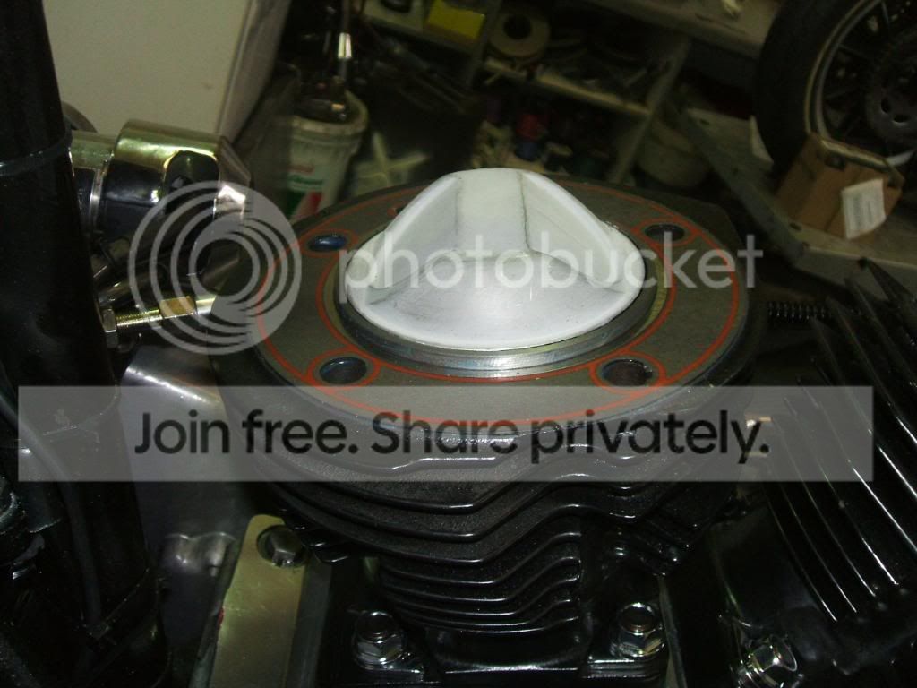

yes sir....my latest little 80"............i'm looking for the pictures of how i cc'd the whole setup using liquid. when you sink valves for valve to valve clearance it changes the compression ratio as you know. i'm at 11.7 mechanical and had to change the cam to make it kick start friendly. she's somewhere around 9ish:1 dynamic (haven't done the math), but the dual plugs help with detonation. this motor doesn't like to sit in traffic, but does love to run.

this isn't my picture, but the use of the burette is the same...water, food coloring and a touch of dish soap to reduce surface tension.....same concept for the piston, drop it in the hole 1", some grease, and fill away....do the math and bingo, EXACT numbers for calculating.
