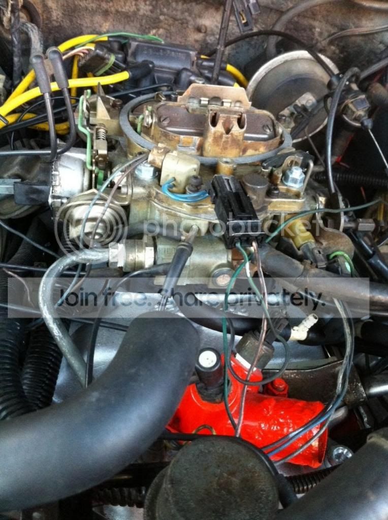

Hi,
I am new to this site but I am in need of some help. I bought my 86 blazer from a young man here is southern California but was not aware that the blazer came from the state of Washington. It came with no Smog emission parts and now after thinking that I would be an easy fix I have reliazed that it is not. I have purchased 90% of the parts needed but I now either need full array of pictures of some ones blazer that has all of the parts on it so that I can duplicate the process or maybe a referrel to a mechanic here in the Whittier area for some help.
I hope to hear from someone here who can help me with either one of this solutions.
Again thank you 86caliblazer
