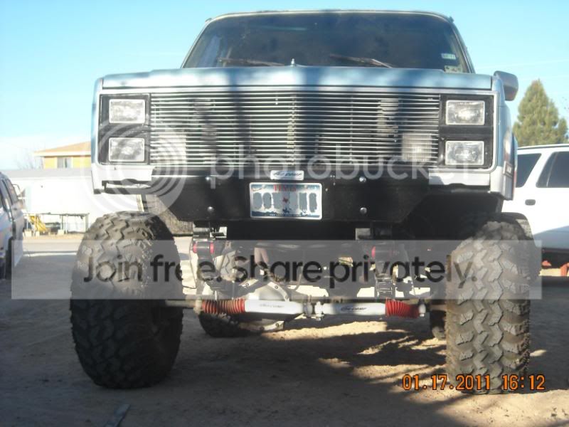

Ok, I get where you're going. For now this truck will be all show no go. Upgrades on differentials and axles, gears coming later on. Stearing is what I would take care of when I'm doing the lift. I just want the look at this point , then work myself up to all the upgrades in order to take my rig offroad. Let me put it to you this way,I would not even climb on a 2"boulder with my weak differentials and that size tire . :D This is my truck as it sits now, with a little fender trimming.

If this is your truck in its current state, LEAVE IT ALONE. It looks damn good, almost perfect the way it is.
Thanks , but I was about to trade for a stepside that had 49" iroks and the deal fell through. So now I'm left with the itch for a way bigger rig . :D
