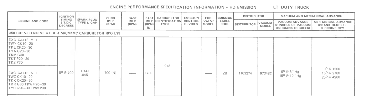

Here are the specs for the engine/carb tuning.
