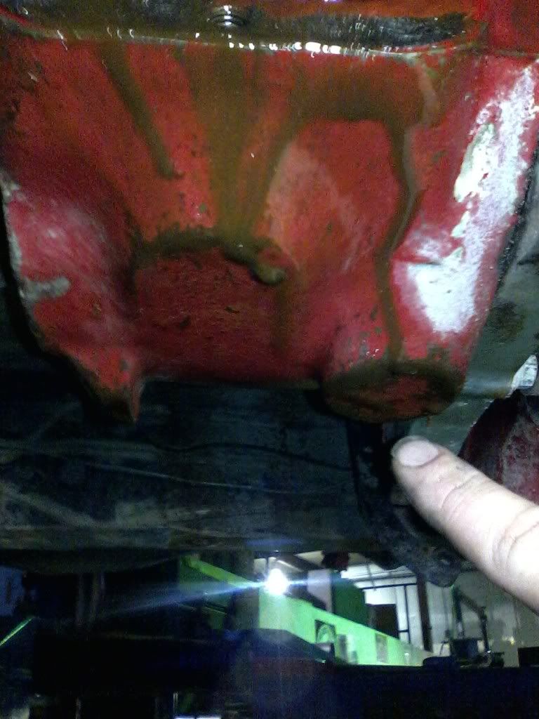

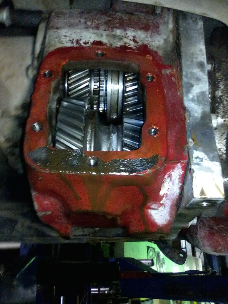

My range box on my ORD doubler is an NP203. It has no oil drain. It is a mess and a nuisance to drain it out of the PTO cover. Is there any reason I can't just drill a hole in the bottom of it, tap it with a pipe tap, and plug it?
Martin
I was thinking of drilling throught that nob I am pointing at.

Once a year? I submerge this thing in running water. Also, why not? I have to use my fingers to scrape the oil over the edge of the pto opening. Then shove rags in there to gwet the rest of it out, would work much better with a hole at the bottom.

been so long since i did mine cant recall if casting blob is good point or not.
i almost think the middle flat spot be better.
i got a ford divorced 203 box on the bench at work now but not sure if its the same.
I was looking at my 203 this morning and where you indicated would be fine. Worst that can happen is you would drag the plug on the ground or a rock and rip it off.

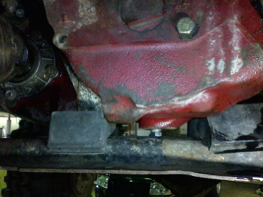

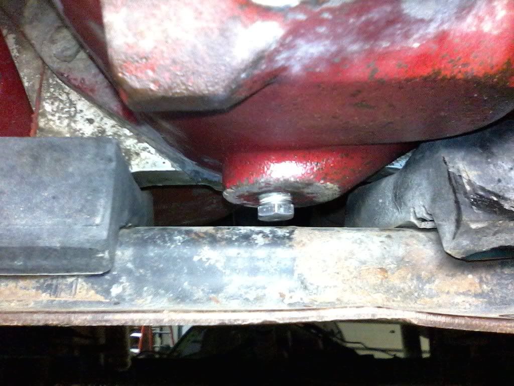

Too late, the hole is already drilled. I am already using a recessed plug. I am now just waiting for the grease to quit running out so I can tap the hole.

Also, I lied about using a recessed plug. My buddies shop that I am working at was out of stock on recessed plugs. Oh well, it it gets hit, that means I ripped my crossmember off, and I'll have bigger problems than a damaged drain plug.

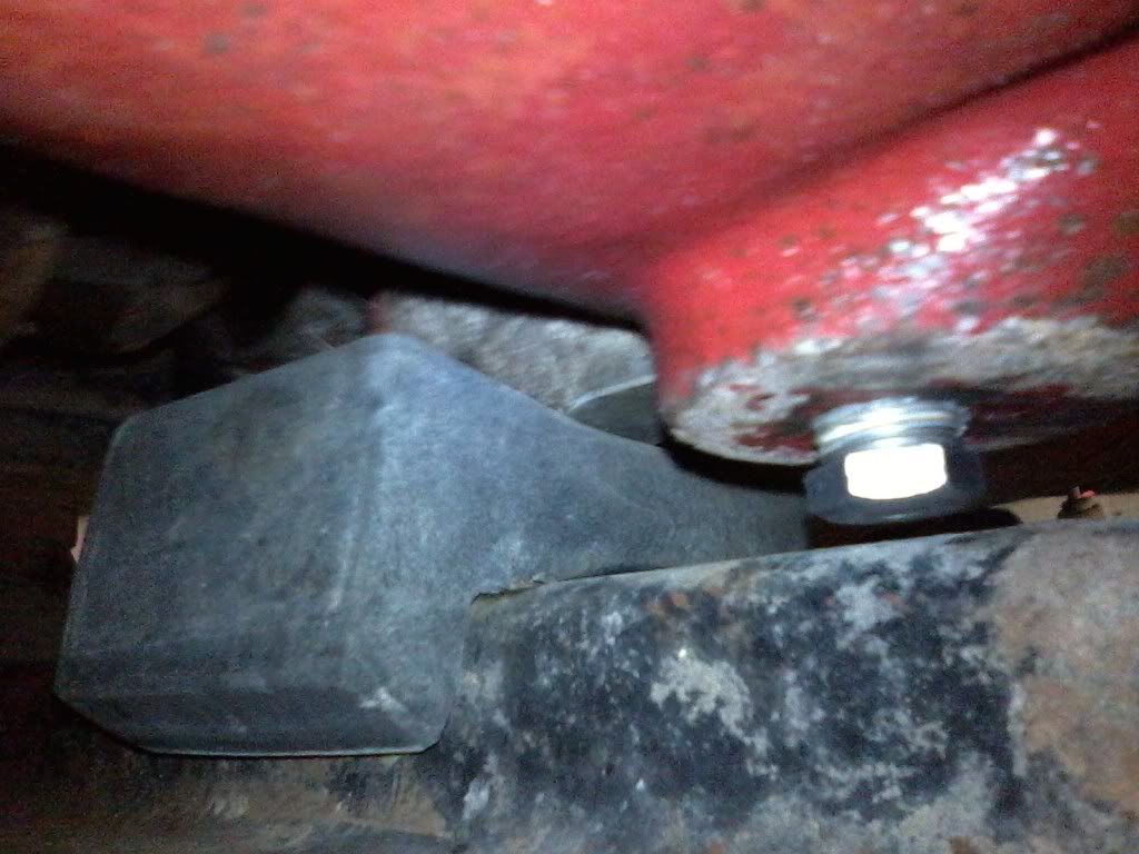

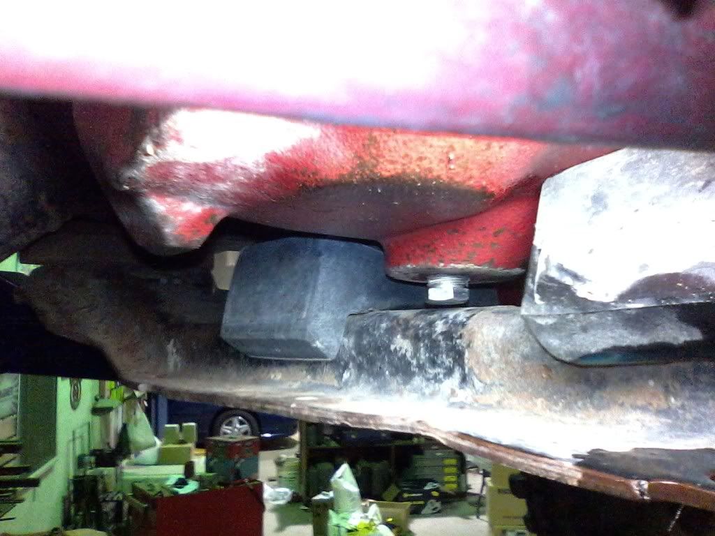

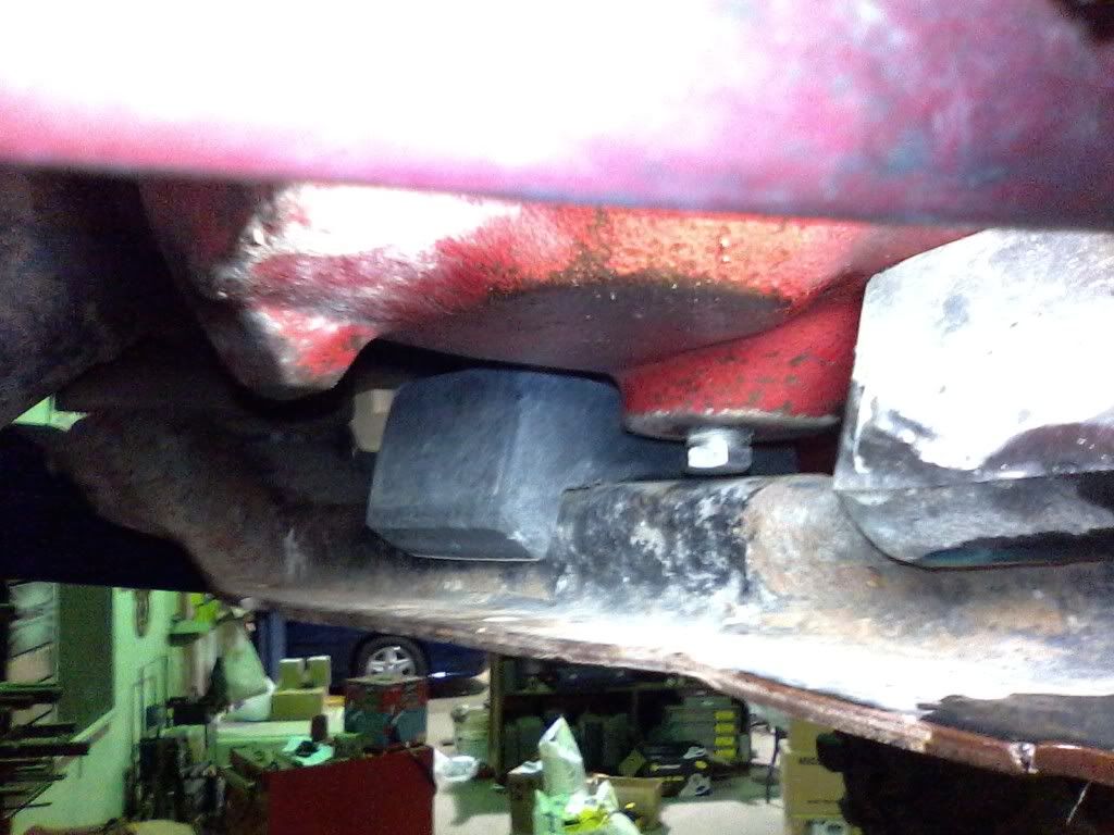

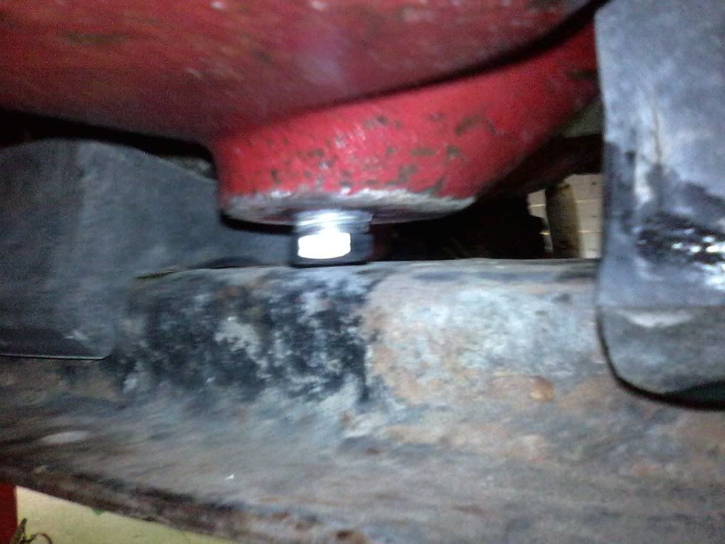

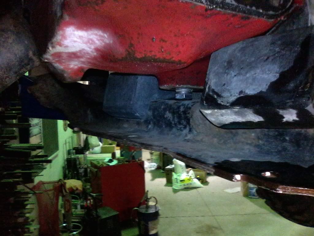

You're going to regret asking for pics. I took a bunch of them underneath looking for a good one, and just emailed them all to Photobucket from my cell phone. Here you are:
Martin
