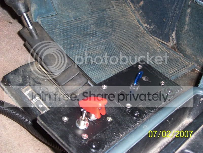

Here's a pic of the switches and one of the winch... it's not pretty... but it'll work. I lost my controller like 2 months ago, and believe me, you get spoiled using a winch... :haha:
The P.O. of the winch had already wired the winch with a 3-prong house plug, so I left it, just replaced the wiring, but it works surprisingly well. And when I get another controller, if I ever need to stand back further, I can just plug an extension cord in! :haha: That's the plug draped over the top hanging behind the winch. Kinda hard to see.
Here's shot of the switches... Like I said, it'll do for now... :o Notice the original pimp floor mats! :D
