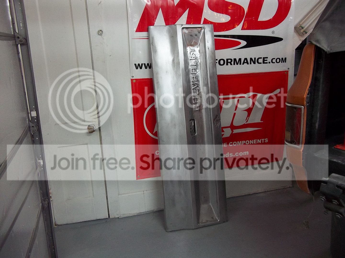

I have a 76 GMC K5. It has a tailgate with a roll-up window in- someone was trying to "work on it" before me and all the guts are exposed... I got to thinking, I don't ever ever roll up that window and I plan to sell the hard top and replace with a soft top- or just go topless- anyway.
Can I replace that tailgate with just a plain old truck tailgate- no window? Anyone know if there is a window-less tailgate that will fit my K5??
any pickup 73 to 87...

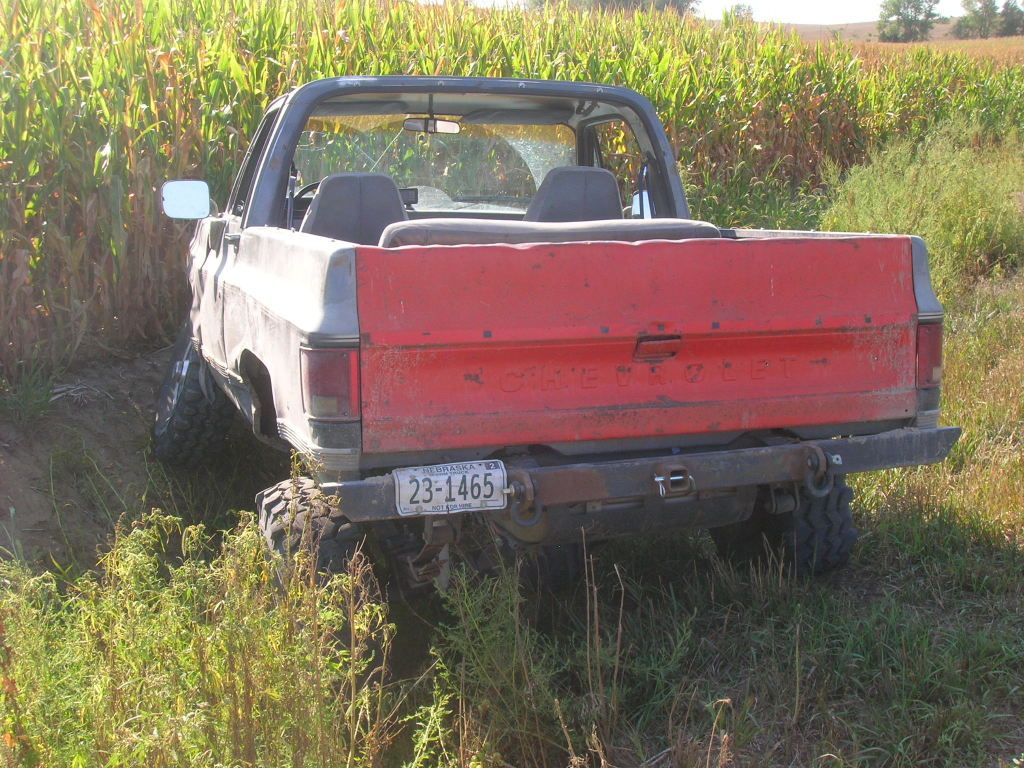

Here is a picture of my 1990 K5 with a tail gate off of a 1976 K10.
Here is a picture of it folded down.
