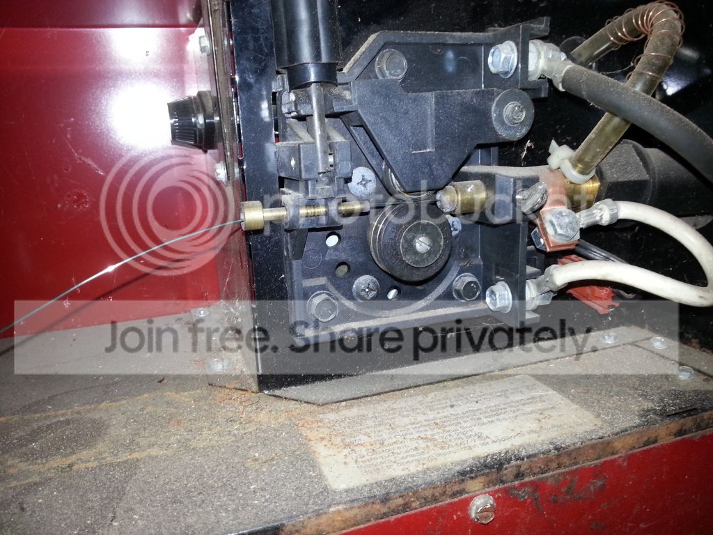

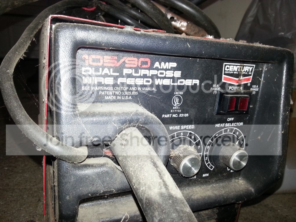

My welder, an older century mig, has a broken wire somewhere in the stinger (whip) and only works if you curl the stinger just right so the wires touch again. So can I just gut the stinger and replace the wires? Or do Ihave to get a whole new one? The welder iitself stillworks fine. Althou gh I have flux core wire in it now and want to swap it over to gas. I assume it'sas easy as addi ng the bottle? It has the little nipple on the back for it.
The part that goes into the welder, if you slide the big rubber both back, the wire can be fixed inside there...
