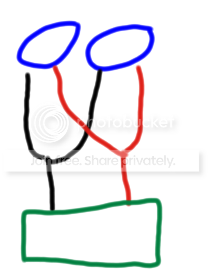

Hopefully this pic makes sense. This is how I would be intending to do it for each front channel. Obviously the blue are the speakers, green the deck, and red and black the wires to the speakers.
Yep that's parallel, so take the ohms of the speakers and divide by 2.

Yep that's parallel, so add the ohms of the 2 speakers and divide by 2.
You must've mistyped. According to what you said adding 2 4ohms speakers together and dividing by 2 would still give you 4ohms when it should be 2ohms.
The correct equation is:
R(effective)=R1*R2/(R1+R2)
or in the case where all the resistors in parallel are the same value:
R(effective)=R/N where N is the number of resistors
You are right, totally my bad. Yes just divide by two. Forget the add part of that, sorry I didn't get much sleep last night. I'll edit my previous post.
