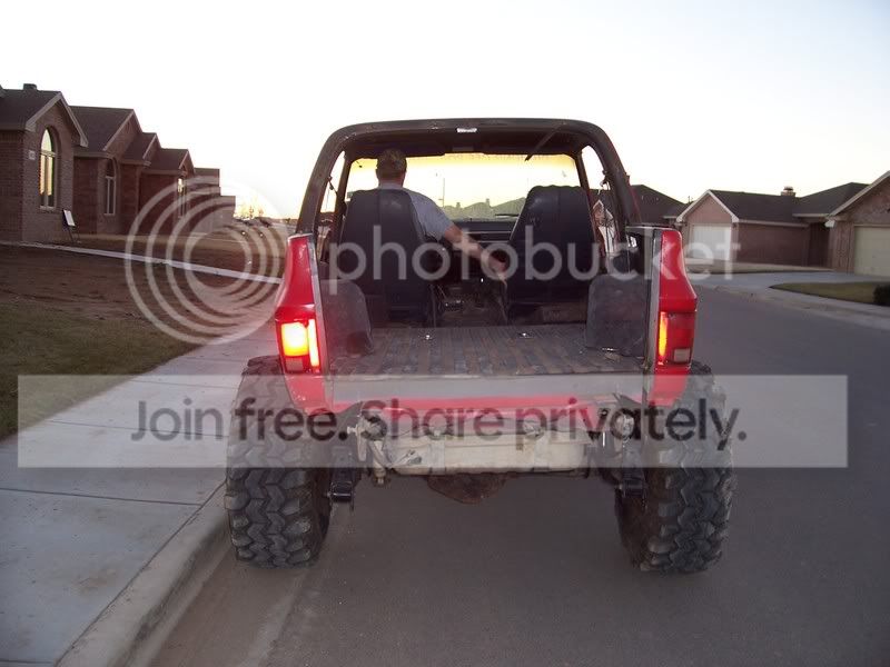

not sure if this will help but here's mine so far. fenders will be removable & attach to the 'cage...

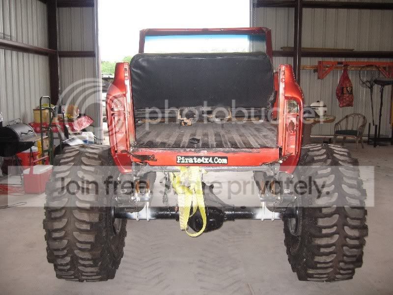

Here you go. Hope this gives you some inspiration. :hack::grind:
thanks guys.:waytogo:just tryin to get an idea how narrow i want to go.mang i love the way that looks.tee hee i can't wait.it will be easy as my whole rear section unbolts.the floor is two plates of steel,the fenders are on one inch sqare tubing.8 bolts and i have a chassis cab.:bow:
I'm probably lopsided or something but how come in both pics of your guys' rigs it look like the left side is leaned out a bit??
Sorry if i sound critical
Ok, Mr. Critical...zoom in on the pics & you'll notice the fenders are being held on by clamps...they're not welded on or attached yet, that's why my left fender looks lopsided...:rolleyes:. :haha:in all seriousness, i noticed that mudman's left fender was also crooked :eek1:
Mine was leaning out a bit from pulling the fender in. You could push it back up straight so a little bracing would have fixed the lean.
If and when you get around to doing a taper, when I did mine the fenders had a definite desire to lean out as well. Inside the tail i braced mine up to the tube work to help keep things straight.
