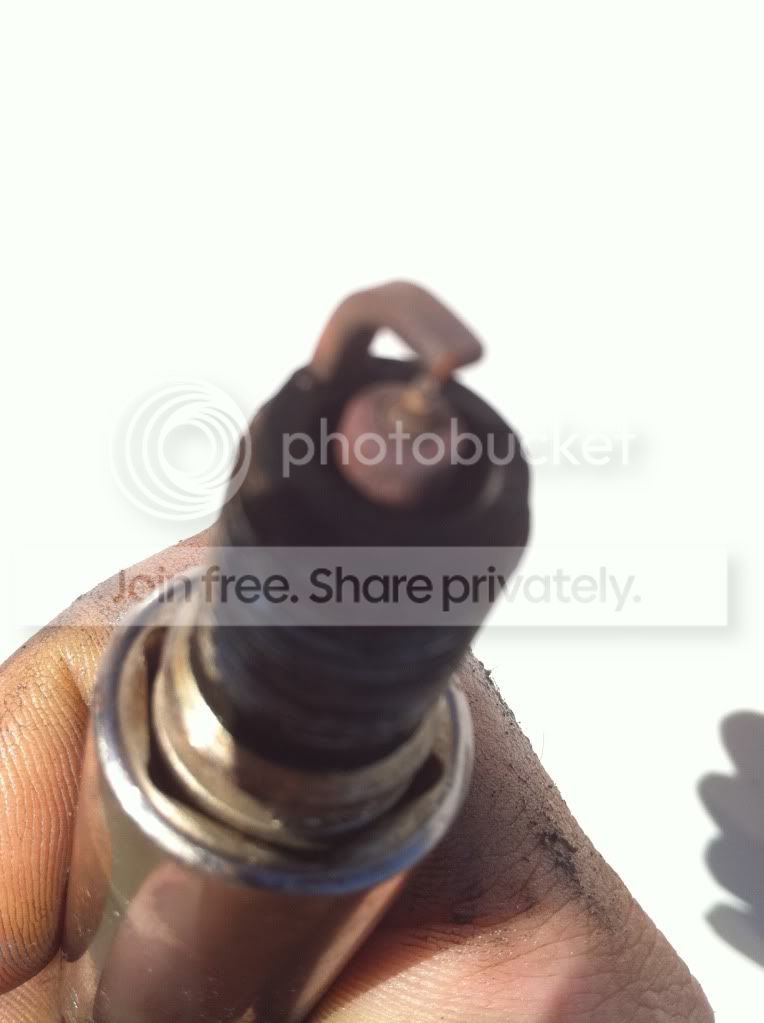

Can someone read these spark plugs?
GsxrMike
Feb 12, 2008
1,702
2
Tonganoxie, KS
I can't get a good picture down around the cone but can you guys tell anything from looking at these?
They seem a little strange to me. They are in a '96 5.7 vortec.
Looks Ok. It is typically hard to read a plug running on the new pump gas. It will add the red tint. The heat line on the electrode looks right.
Whats up with the two different colors seperated by a line on the insulator in the first pic?

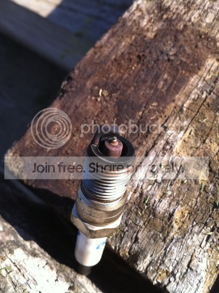

And whats up with all the lines on the insulator in the third pic?

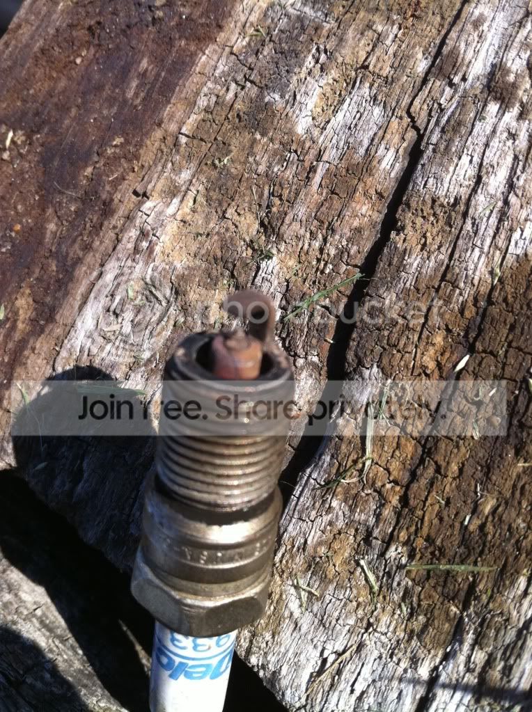

Sorry 2nd pic sux

Seriously though, if you put the plug on something solid in color like a piece of paper it would help the focus, the third picture is the only one in focus, the other pics we can't see anything that matters.

The color change has to do with the way the flame comes out of the plug gap. If you would have only put a few miles on them one side would be white. The only really good way to do a plug read is to do a plug chop. That means new plugs, run at WOT then while wot shut off the engine with the key. Then pull over and pull a plug and inspect. Otherwise you have half a dozen throttle circuits you are looking at on one plug.
Cool cool, I was just kinda wondering why they had the vericose vain looking thing going on. I wanted to get it dyno'ed anyways but I checked the compression the other day and had the plugs out and just wondered.
