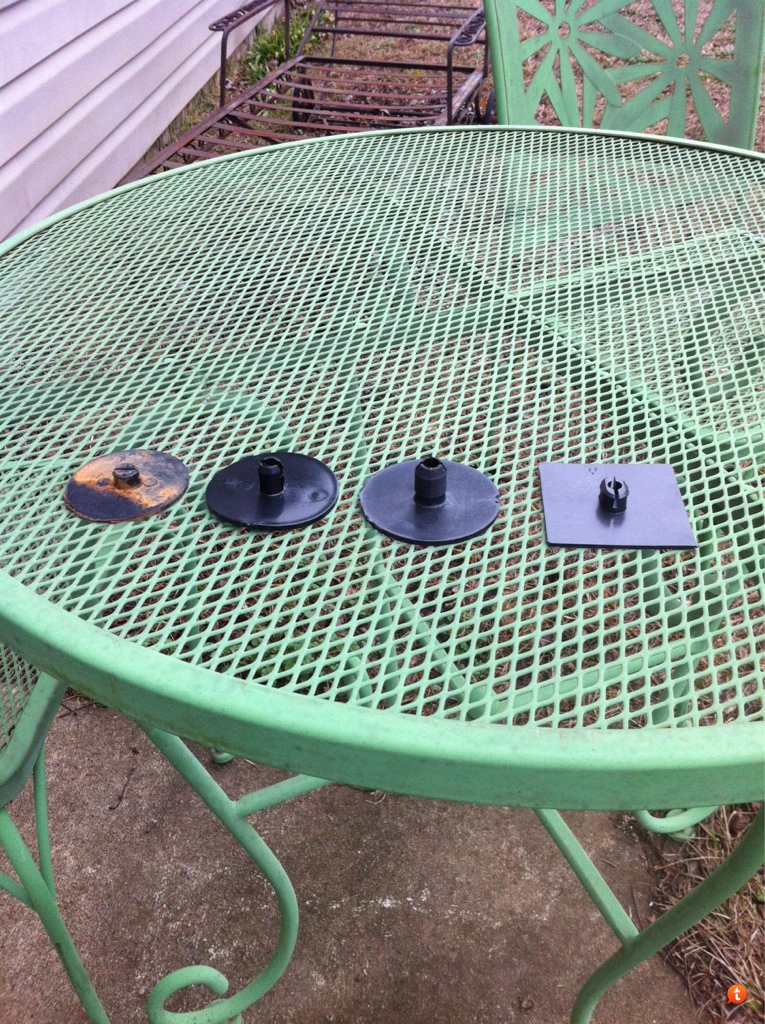

I have a pair of Tuff Country EZ Ride 4" lift springs on the front of my '85 half ton. They started squeaking real bad, so i took them off and disassembled the spring packs to paint them and replace the bushings and stuff. Thing is, I can't find the Teflon wear pads for them. They were all either trashed or missing, thus the squeak. I ordered some pads that were supposedly replacements for the stock rear leaves, but the tabs on them were too big for the holes on the Tuff Countries. I tried shaving them down but they broke when i tried to press them in.:doah: Then I ordered some that were for Skyjacker brand springs, but they have square tabs on them that are way too big.
So has anyone ever replaced the Teflon pads between the leaves of a Tuff Country spring pack? I called the place that i got the springs from (ORD), but they can't get them. I called Tufff Country a while back. The guy said he would get back to me but never did.

I finally was able to get the proper Teflon wear pads so I can get my spring packs put back together. Big thanks to Chris at Off Road Design. I called Tuff Country again and talked to 3 different people but I couldn't get any response to my questions, so I called Chris and he got back to me the next day with the right part number and even told me the cheapest place to get them from. I only paid $1.95 per pad! Chris is the man. In fact everyone I've ever dealt with at ORD has been great - not just Chris, but the Watsons also. Thanks again and good luck at King of the Hammers (if you're going this year).
In the pic, the pad on the left is the sole survivor of the original group of pads. The next one is the proper replacement pad. The third is one that was advertised on Amazon as being for the "rear springs of GM trucks". And the one on the right is one I got from Summit that's for Skyjacker brand springs. In case you need the right pad for your Tuff Country springs, the part number is Teflon-05. It's also called an N97 wear pad.
