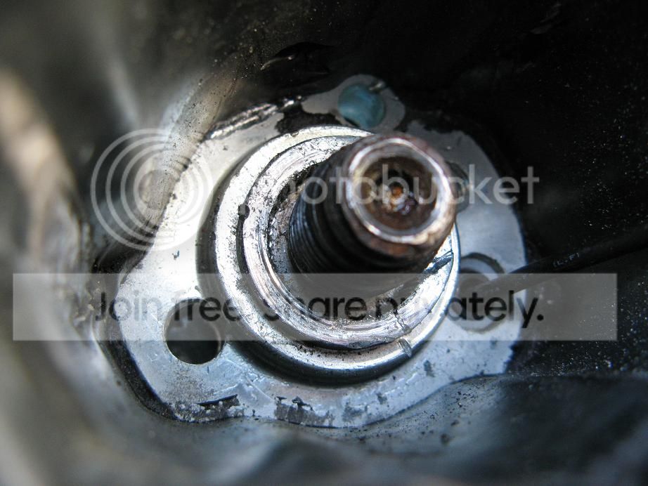

Swapping out my Grant wheel for a 90's truck wheel. The wheel will only go on so far. I'm not sure what I'm doing wrong but I've chased the splines with a file to get the old crud out. I've got another 1/8" to go before the splines are flush. I've torqued on it like it were a lug nut, just coming up to the line between stupid donkey and just right. :doah:Also, I've got a washer under the nut, I don't like grinding.

How is the space between the column and the wheel itself? I just swapped in a 92 wheel and removed a grant and it went on no problem. I can not recall if the splines were flush, but I would think that as long as you torque the nut properly there is plenty of spline contact in the picture you posted.

yeah, I get that, but it doesn't seem to go on very far. My Grant adapter went on more. I don't remember my original wheel. You know how there is two sets of splines at the top, I'm sure it's only touching one.

The splines do not sit flush with the wheel hub. That pic is about as far as it should go.
Yep. There should be a gap between the base of the wheel and the column, that's why the lock plate has a plastic trim cover on it, so you don't see the ugliness when everything is put together.
