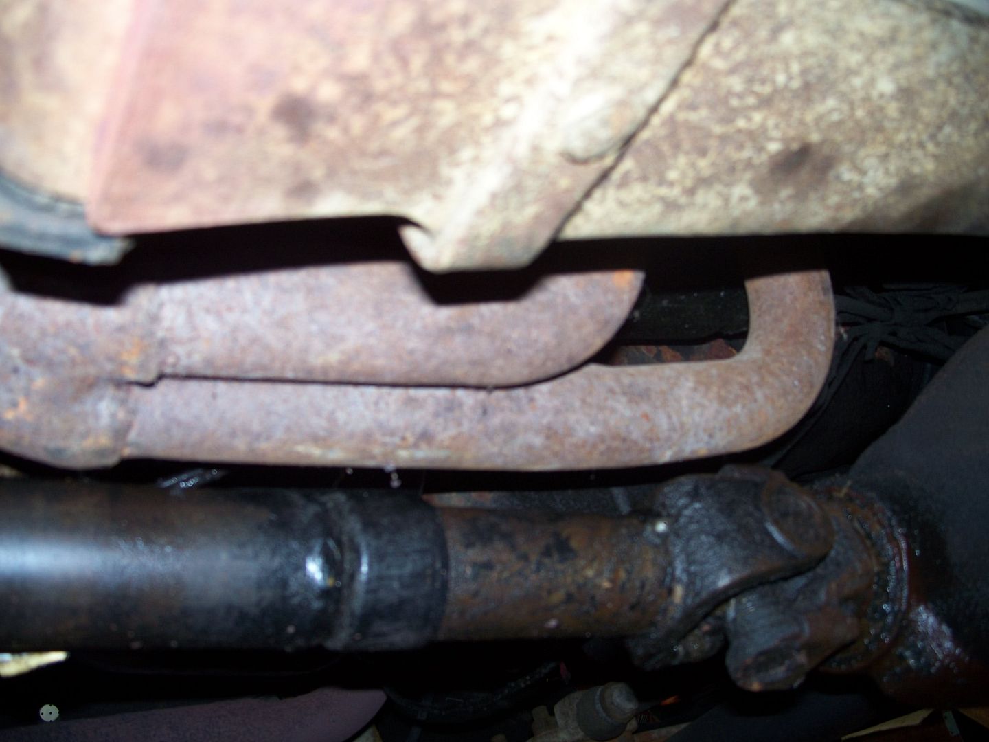

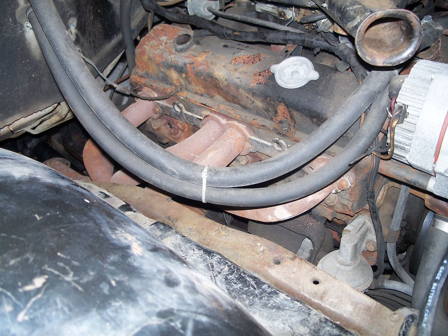

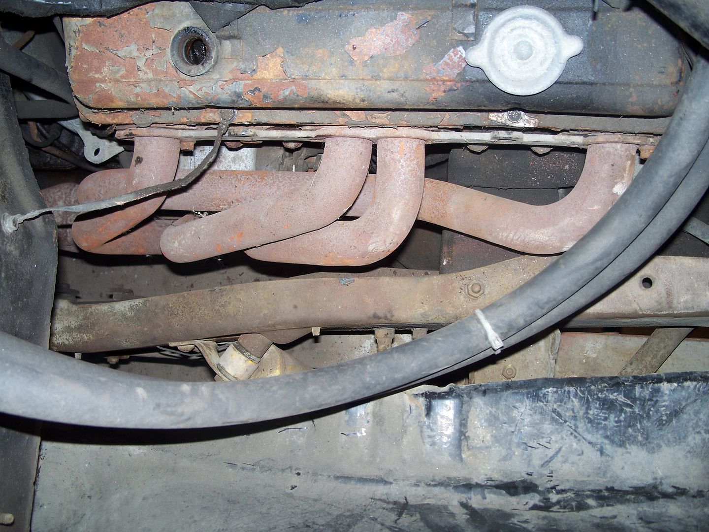

This is the Chevelle down pipes and manifolds off MY 70 project Chevelle , put onto my 75 truggy K5 . I am pretty sure headers would fit if these do , I have all kinds of space between the floor and the Chevelle pipes as bolted to the motor . Remember headers for Chevelles would line up with the pipes under the Chevelle :

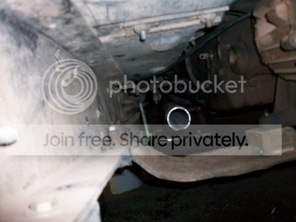

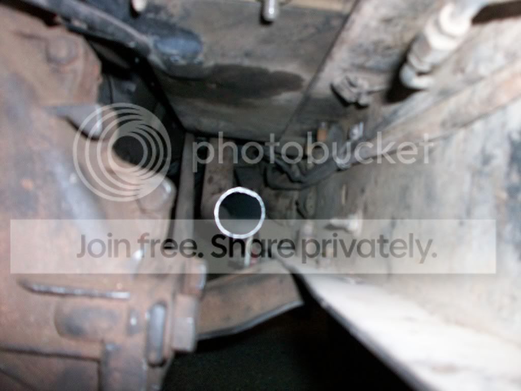

Here's the verdict:
The headers from the Chevelle drop down plenty to clear the floor of the K5 and they are very close to the trucks frame rails and probly could hit if the motor mounts are worn out or you get a lot of torque twist. Notching the frame or pounding a small dent in the one offending tube could get you by.
But heres the catch, the length and size of the collector on the Dougs headers I have interferes with the shackle on the rear of the spring. Keep in mind I do have extened shackles 6" long eye to eye. So no go on the Dougs Chevelle headers,

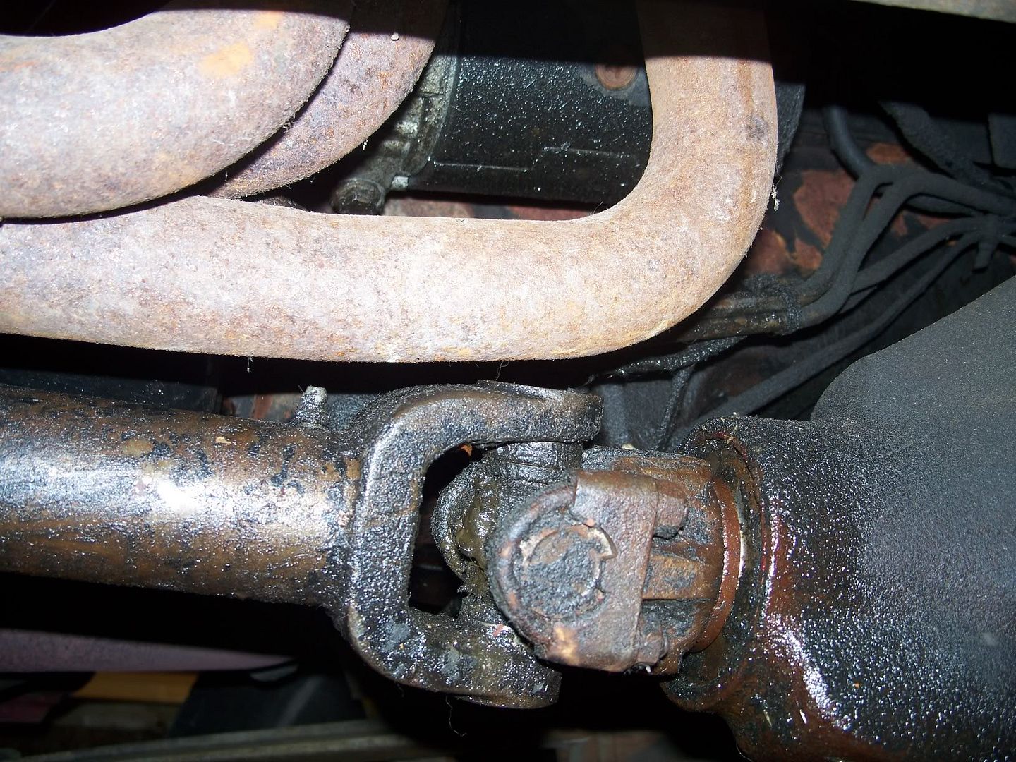

I had a set of hooker competition headers off of my 70 Chevelle that I tried to put on my 74 K5. They bolted on nicely, but the passenger side was VERY close to the front driveshaft. Too close for comfort.
