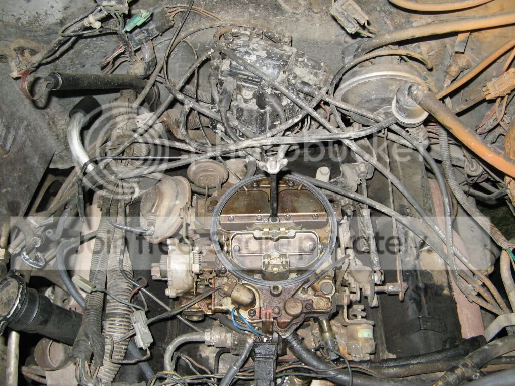

If I had an original electronic quadrajet and have since replaced it with a non-electronic quadrajet, would that effect the running timing advance due to missing signals from all the electronics no longer present ?
If so, would a MSD ignition 6AL control resolve the issue ?
My 86 350 idles stupid sometimes, all the way to stalling. The only major change since last smooth running is the basic carb from SMI.
My idea is that because the computer isnt getting a "what to do" signal from the 2 gizmos on the old carb, it just decides to run safe mode rich by tweaking the advance at times, causing the engine to stumble.
Any possible truth in the above idea and solution ?
