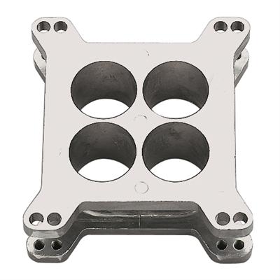

I'm thinking of using a carb spacer on the street toy. Intake manifold is a Dart "Kool Can". Carb will be a Demon carb. What spacer would you use ??
Depends on what you want out of it.
As a rule:
The open spacers increase the plentium size of your intake. These spacers will help build power on the top end.
The 4 hole spacers increase the air velociy at low RPM. Giving more torque on the low end.
You can tune your engine by using diferent thicknesses or even combinations of the two..
Carb spacers are basicly something you use to tune an engine after you have everything else dialed in right.
It'll be used on a basicly stock 305 till I can build the 327 I want. It's a 78 El Camino. Maybe this one.
Well, I ordered the 4 hole 2" spacer and a stud kit for the carb. It'll go on my Dart intake manifold.

i guess, my ?? would be..............................why? /forums/images/graemlins/confused.gif /forums/images/graemlins/confused.gif /forums/images/graemlins/confused.gif
usually a spacer is used to enhance or change performance. On most of the new computer designed intake, as you have, they are NOT needed. They are designed with the best flow characteristics in stock castings. I could see doing it with older designed intakes, as many of them sucked out of the box!

[/ QUOTE ]In all honesty, it's a $20.00 part. I want too try it with and without too see if there is any difference.
I can only see adding 2" to the intake as a restriction in a 4 hole design. 1" seems a little more reasonable but I must agree with BAblazer, I just hope your dyno(butt) doesn't lie to you.
