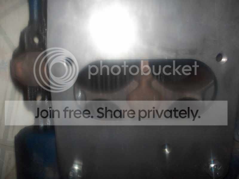

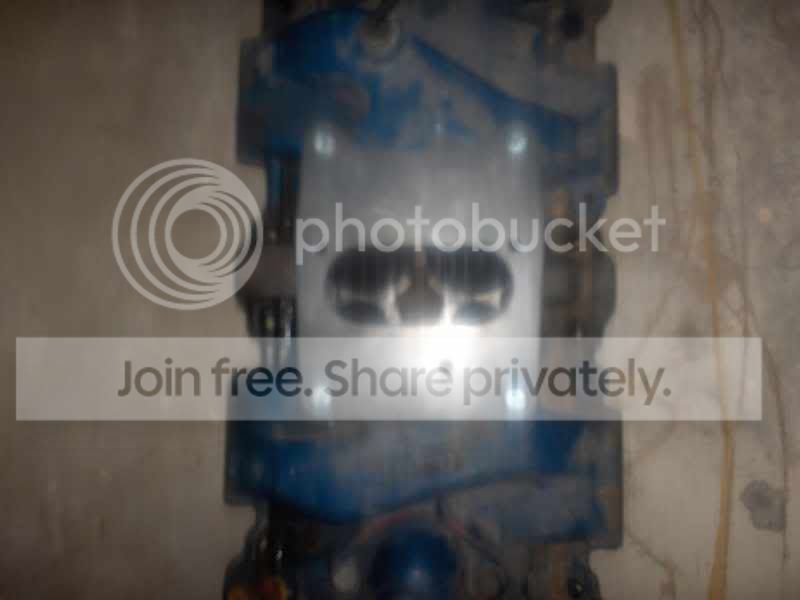

Here is a pic of the transdapt # 2211 center mount I got from summit.
As you can see the center mount does not line up too well with a stock castiron manifold. The rear mount # 2206 would have been a better fit if you are trying to use the stock manifold.
I ended up using this adapter on an edelbrock intake, so far it looks good.

That adapter needs to be used with a dual plane intake and not the factory style manifold as you have pictured.
Thats why you might notice the intake is no longer on the motor;)
When I found out it wasn't going to work, I decided to use an edelbrock intake.:D
But I though it might be useful to take a pic to show a pitfall to be aware of:doah: , so the next guy can order the right part.
#2211 centermount
#2206 rearmount.
:laugh:
