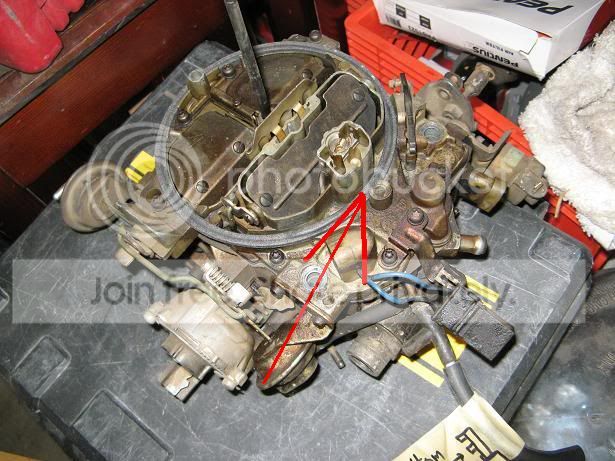

I don't know what this screw is called but I read it's for the off idle performance. I turned the adjusting screw 2 full turns counterclockwise in an effort to richen this circuit. I didn't feel anything noticeable when I drove it afterwords, and my A/F gauge didn't either.
Do I turn this IN to richen or OUT? If I'm all the way out already, this needs a new jet and start from the beginning huh?
The screw is located under the gasket on my current carb. This is a picture of my old carb which doesn't have access to this screw.
Also, how do I richen the entire carb up without changing jets. I'm just looking to fatten up everything BUT idle, and then go from there.

The ONLY real way to make the mixture richer is to change to a larger jet OR decrease the amount of air that can enter through the carb (impossible to do). So looks like you're changing jets or leaving it alone.
I guess I need to specify :)
I'm just looking to get it as rich as possible so I can drive it to a couple places. It's too lean right now. One of the places will be the dumbass carb guy I'm working with. He hasn't changed any jets yet, just likes to turn things and say "try it". He has a whole draw full of Qjet needles and jets.
So, I'm just looking to richen it up as much as possible temporarily. The screw I'm talking about in the picture is all the way out. I feel no resistance turning it, it's wobbly, but can't be pulled out.
