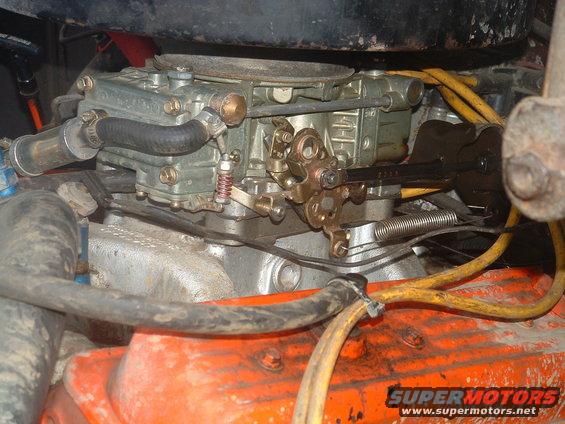

its wired...
A Q-jet for a computer contolled vehicle will have some wires going into the top of the air horn under the air cleaner.(they go inside to the "Mixture control solenoid")....the vehicle will have an O2 sensor too...and a computer of course..you could also look up the carb numbers and see what year and model it originated from..--most of them I've seen were on 82-87 GM vehicles..:crazy:
