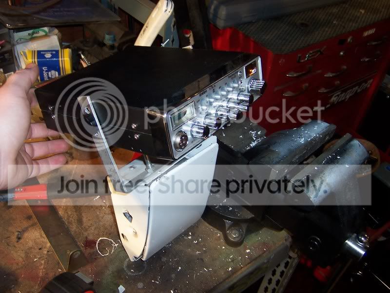

The antenna is mounted on top of the roof, and it unscrews so it doesn't have to ride up their when not used.....and the cb unit is in front of the console. I just made a bracket for it and ran the cable under the carpet.
