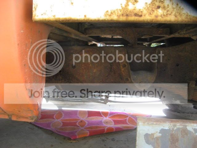

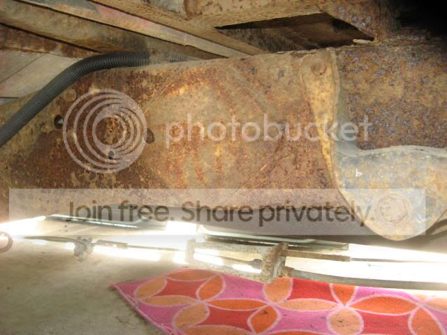

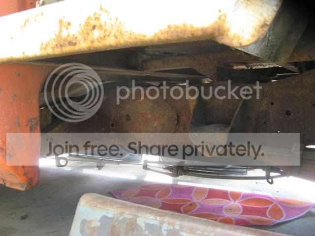

149.5" would be perfect for a short box. My '87 CC was bought originally by a forestry company. They shortened it to 149.5" and added a fabricated utility box. One frame cut in front of the spring hanger, welded and fishplated.

I can take some...prolly get them up later today.

Not too much to look at really...especially with all the "camo-rust". :p:

Mine has a K5 style tank now, and I didn't do the shortening job. To lose 15" of wheelbase you'd have to take 15" out where mine is spliced. Rear overhang cut to suit I guess. 6" less behind the spring hangers sounds about right though.
