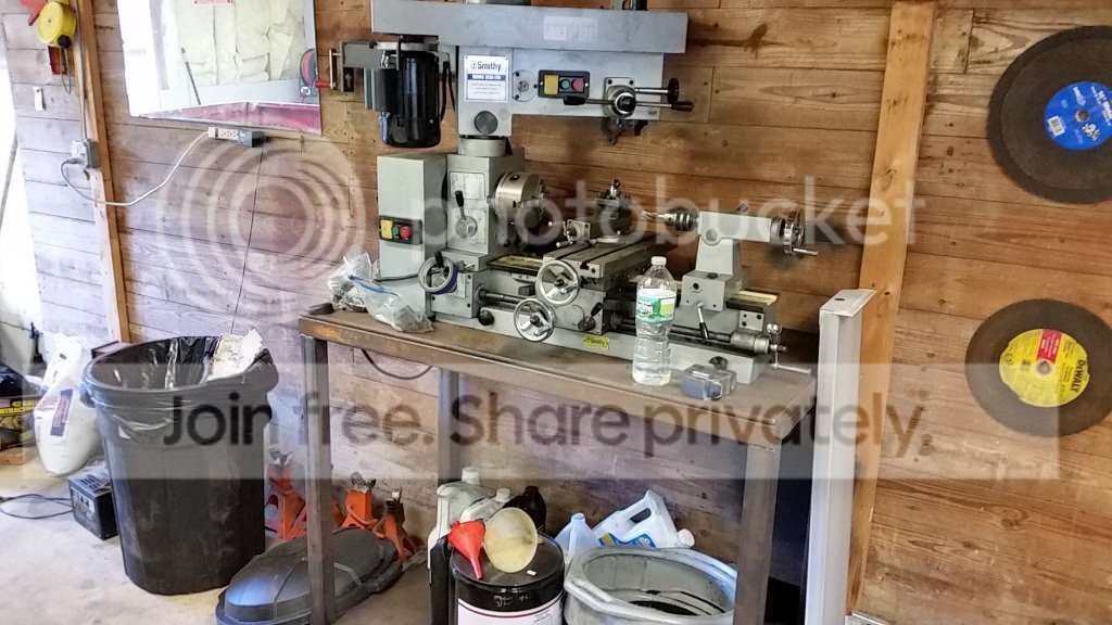

I was never happy with the table I built. So I lowered it 4" and stripped the 1/2in plate top off. Decided to use that for the lathe stand and did the top of the fab table with gapped C channel so it can be clamped everywhere. Its super flat.
