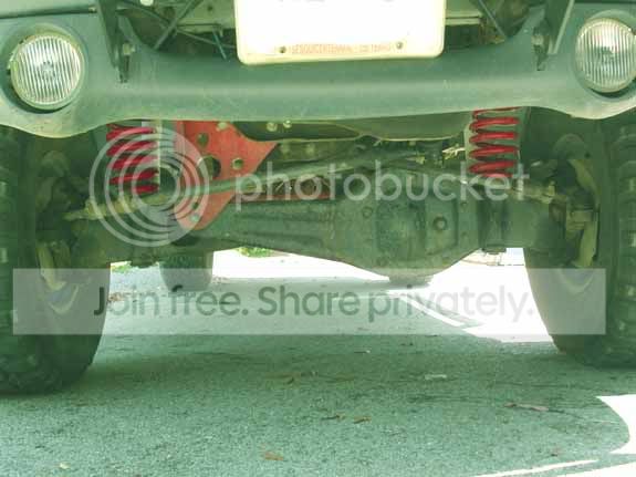

This is an example of the 'y-style' I wouldn't bother with at all:
