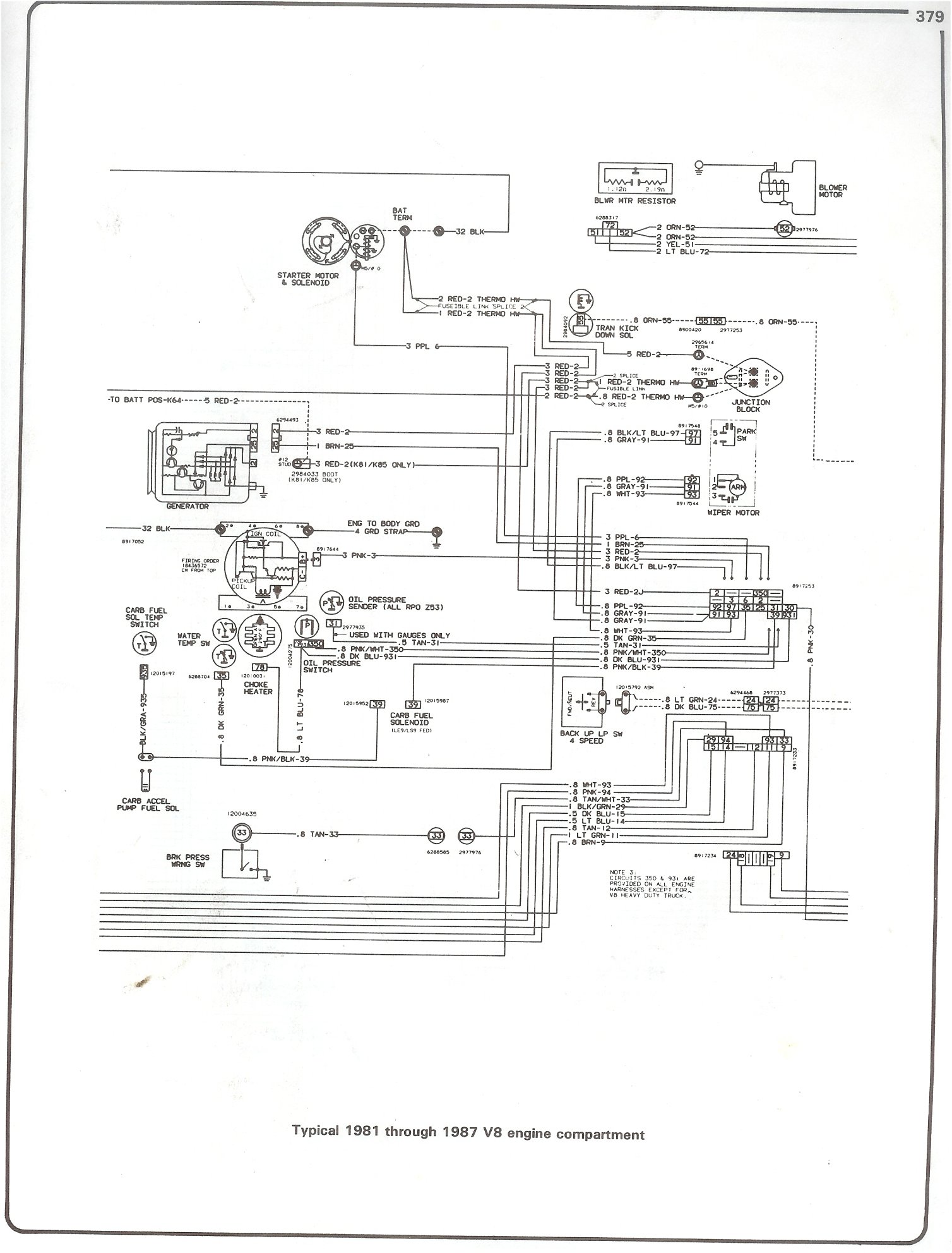

The bell shaped one is your oil pressure sending unit, and has only a single wire to it. That is what runs the gauge. I *think* the choke switch is tee'd off of that same oil pressure tap however. You'll see it if so.
It's a simple on/off switch AFAIK. Check for continuity across the two terminals with engine off, and engine running.
Only way to verify if the gauge oil pressure is correct is to get an external oil pressure gauge that is known good, and compare it's readings with your gauge.
Yes, the sender with 1 wire is for the gauge. The 2-wire is a switch that powers the choke. This prevents the choke coil from heating before the engine starts.
If the behavior of the light corresponds to RPM and engine temp there's a real chance the pressure is low. Check that out ASAP!
Ill be sure to add that to things to check, oil pressure according to gauge reads okay at about 45 psi under pressure, although i dont know how accuret it is as it will sometimes zero out and bounce back or up and down, so ill be sure to check manualy i suppose. Thanks for the diagram and advice at least now i know where to start :bow:
