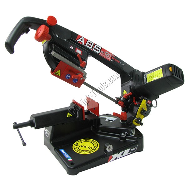

Recently, I bought a Hem Femi band saw. It is semiautomatic based on gravity and spring tension and it is a dry horizontal saw. It has a miter table like a miter saw......or is that bevel? You turn the saw, not the work. I took a 12 thousandths inch thick cut off the end of a 2" chunk or round aluminum bar stock. It cuts better than anything I have seen and you can touch the parts after cutting. The saw weighs 40 pounds and will cut 4 3/4" max at 90 degrees, 3" at 45 degrees, and it will go up to 60 degrees. They make a bigger model, but it weighs twice as much and costs another 700 bucks.
http://www.trick-tools.com/Femi-NG120ABS-Benchtop-Semi-Auto-Mitering-Bandsaw-6366
Before this saw, I used my dewalt 12" miter saw with a composite blade. It has held up for many years, other than the plastic dust collection port. I removed the plastic insert that goes in the table, for cutting steel, and replace it when I cut wood. The miter saw is extremely loud and it throws sparks and steel everywhere. The blade walks on 45 degree cuts and you have to bear down on the saw to cut, but it likes to stall out on 1/4" wall tube.
The little band saw cuts 1/4" wall like a champ. My brother and I cut a bunch of 3" schedule 40 galvanized pipe (0.250" wall) with it last weekend. We made fish mouths so the 3" could be welded to 5" pipe, to build gates. The saw does the work and shuts off when it is done. It is loud, but at 30-40 feet away it is far less annoying than an abrasive saw. I still wear ear muffs to use it. The band saw is far faster than the abrasive saw and it doesn't take any work. The blade is holding up very well.
If you can't afford a fancy compact band saw like the one I got, check out an inexpensive horizontal band saw. I wanted a dry cut saw in the past, but not now. I thought $1500 was too much for this band saw when I first looked at it, but it will pay off with the amount of metal I need to cut.
